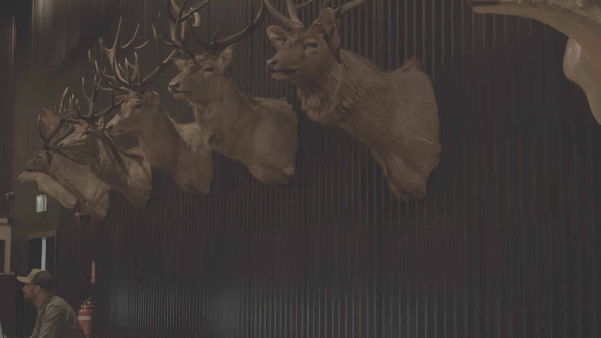

This is how it's supposed to look (and how it looks in VLC and Premiere Mac):

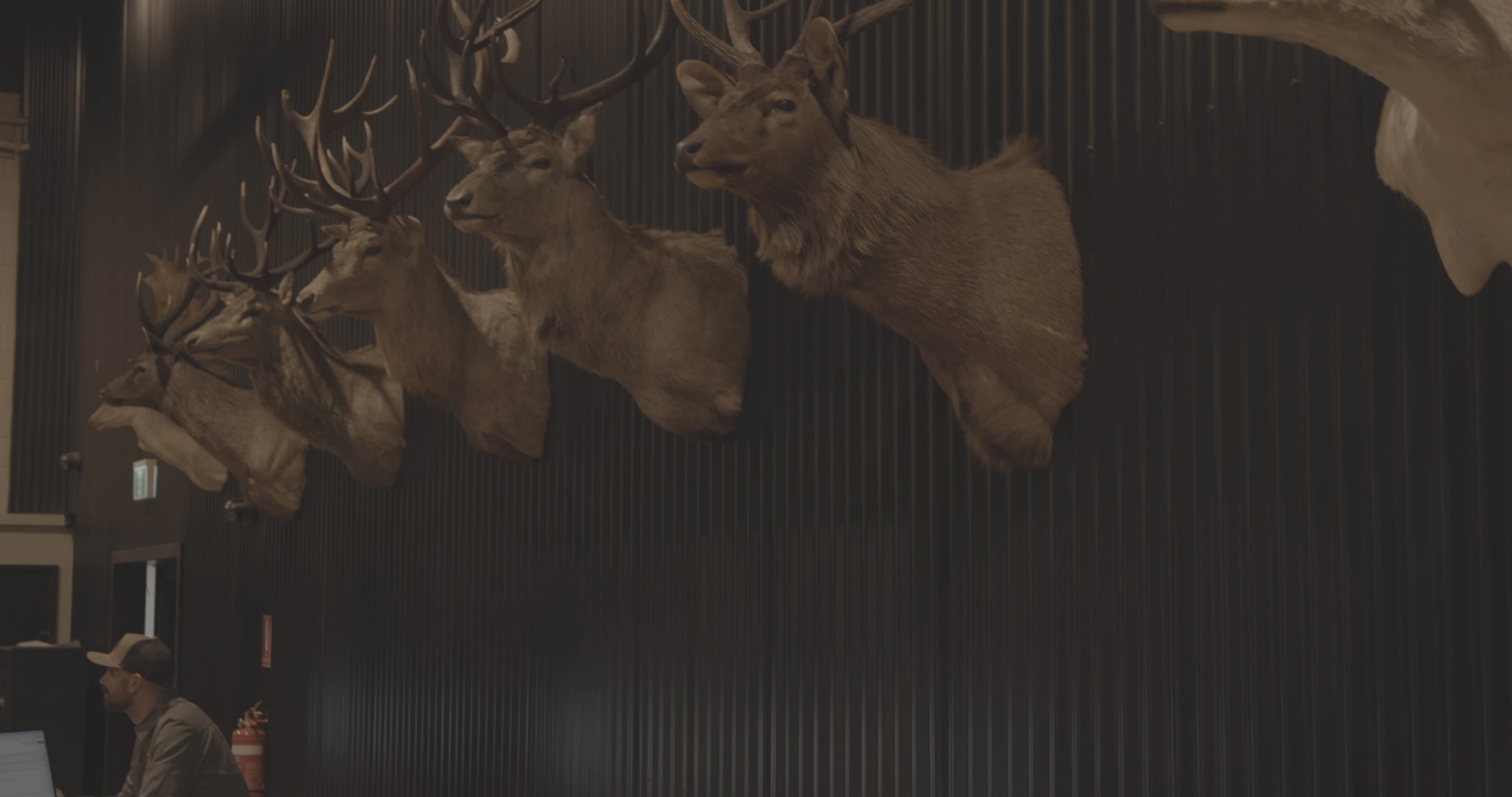

And this is how it looks in my Premiere for Windows:
And when I export said footage directly through Premiere, I still get this gamma shift, but if I use the same settings, but export through Media Encoder, it looks normal (aka without the gamma shift).

Ok, many months later, here's what I have observed:
  • It's Canon C70, not E70. I don't know where I got E70 from, since that doesn't exist.
  • I have since tried it on another PC, also running Windows 11, and the problem persists there also.
  • The problem has something to do with the MXF container of the video files. If I rename the files to .MTS, they appear normally on Premiere, as they're meant to. I have no idea why. My workaround has been renaming all the clips' extensions.
I hope Adobe can figure out why Premiere on Windows shows MXF files (at least the ones created by Canon C70 cameras) with a gamma shift, and why renaming the extension to MTS fixes it.
