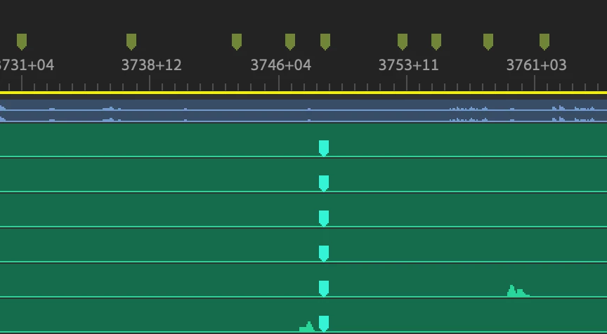

Here's a visul of what I'm talking about. You can see my markers in green at the top of the timeline. In this example, the embedded marker from the studio is shown on the individual audio stems (in cyan). When the studio has numerous markers throughout the timline, it completely slows down my ability to shortcut through my markers. When I'm looking at between a total of 2000' to 4000' of timeline (feet + frames @ 35mm), it gets quite annoying to have to stop and adjust for the embedded markers. (edit: That's about all I can safely post without jeopardizing my NDAs. Apologies.)

Here's how the issue affects my workflow. I receive an "animatic" (.mov file) and audio stems for a cartoon production. The animatic and audio stems sometimes have embedded markers that the studio has used for their purposes. When I work on the project, I need a completely different set of markers that I use to identify scene breaks. My added markers appear above the timeline as normal. The studio markers are embedded and cannot be modified on my end. As I move forward or backward through my markers, If I land on one of the embedded markers, all key controls or shortcuts cease to function. If I use an arrow key to move one frame forward or backward, I can again use my shortcuts to move as needed. That is, until I come to another embedded marker, then it's the same song and dance. This didn't use to be the case. Yes, my shorcut would land on an embedded marker, but it would move right along as I hit the shortcut again. Now, I have to arrow key past the embedded marker to resume moving between the markers I have placed. Yes, it's still an issue, even after all the recent updates.
