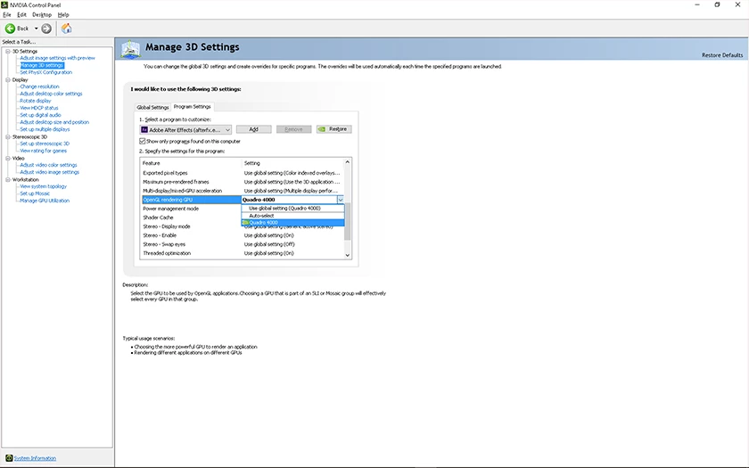

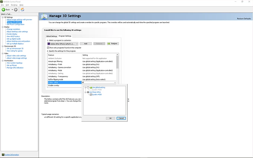

    I was having the same issue with After Effects even after upgrading to the latest Nvidia graphics driver 376.33. Opening a previous project gave me the dialogue box indicating that CUDA acceleration was no longer available and the GPU was not available under Previews/Fast Previews/GPU Information. I'm on a Windows 10 machine (64-bit). What worked for me was to open the Nvidia control panel, navigate to Manage 3D settings/Program Settings. I selected After Effects as the program and changed the CUDA GPU setting. (Image attached.)
    I also changed OpenGL Rendering GPU from AutoSelect to Quadro 4000. (Image attached).
    I'm not saying these changes will work for everyone, especially if you're on a Mac and using CUDA, but they certainly worked for me.
    December 8, 2017
    THANKS I JUST changed the CUDA GPU setting >Select OK then run premiere pro WOKING
