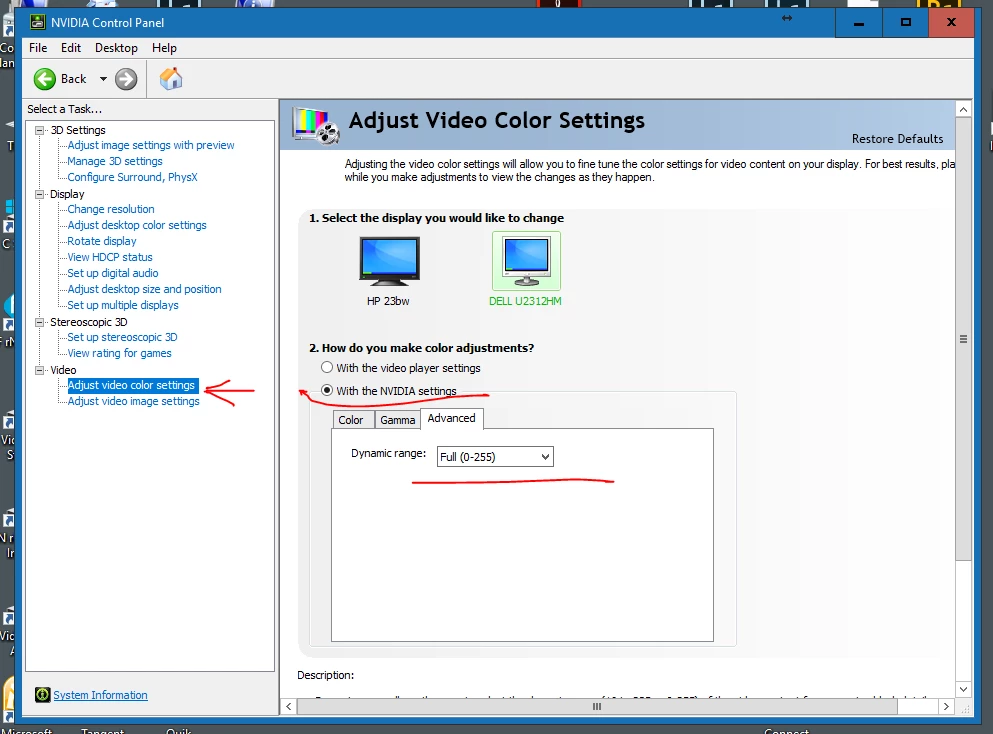

    Here's a screen grab to illustrate my last post.

    While I would love to see things the same across players, apps, web, etc, my biggest concern is how things will look once uploaded to youtube and vimeo. Does the nvidia setting have anything to do with this? or is this only going to change what I see on my own machine?

    QuickTime most often applies it's own idea of gamma & dynamic range ... assuming that PrPro produced H.264 media is 16-235. It's just plain problematic to use for any significant looking at media.
    If VLC is a problem, I'm suspecting that given that you're running an Nvidia card, you need to go into the Nvidia control panel and in the bottom section on setting video color, set the "Use video player or video card settings" to "use video card settings". Then in the Advanced tab, change the Dynamic Range from 16-235 to "Full range 0-255".
    Neil
