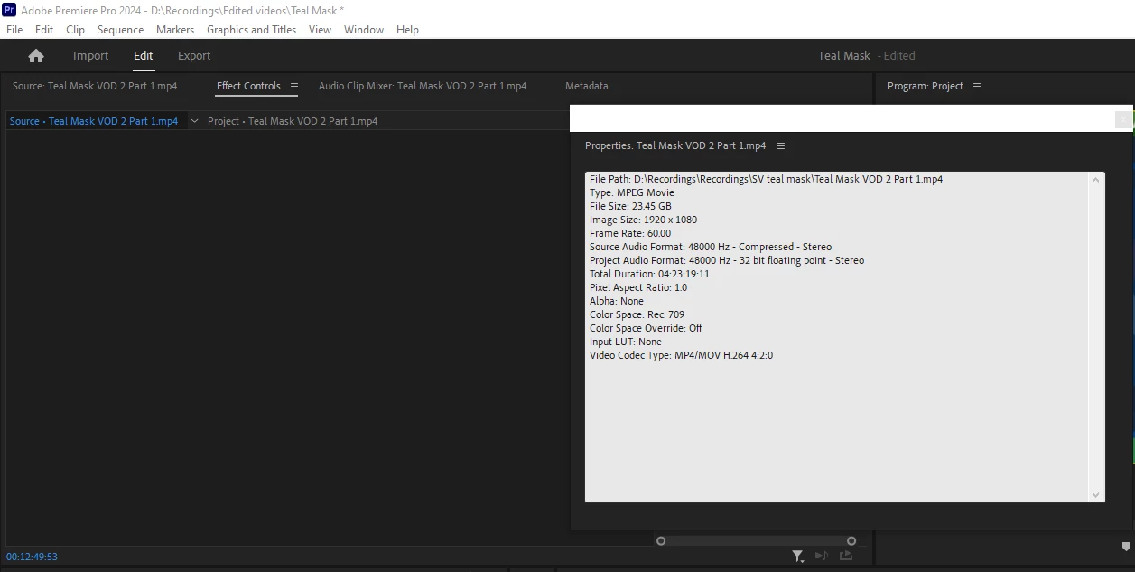

From what I have read it is most likely a VFR issue since the desyncing is occurring in mp4s that have come from OBS. I have checked and OBS itself is not the problem so I followed this guide FAQ: How to work with Variable Frame Rate (VFR) me... - Adobe Community - 10348229 but none of the media is marked as having a variable frame rate and the effect controls do not show the MPEG Source settings.

Thanks for the note. I can understand the issue. The file you are having us inspect is over four hours long. That is at the heart of the problem. Transcoding to an editing codec is untenable for such a file, so did you encode them back to H.264? That may not be the best solution. Sorry for the frustration. It would be great to get all your information in order to help you better: How do I write a bug report?
I suggest recording these lengthy streams with a hardware-based recorder so that you do not encounter these issues in the future. If that is impossible, you may want to explore other settings and test with such lengthy files.

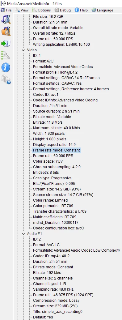

You can use the free MediaInfo program to get info on your clips. Get the program from the link below and using the 'Tree' view post a screenshot of your clip info: https://mediaarea.net/en/MediaInfo/Download
Use Shutter Encoder to convert the files (before editing) to constant frame rate. Maybe try ProRes LT or even ProRes PROXY format within Shutter Encoder for easy to edit formats with 'better' files size.

MediaInfo says that the frame rate is constant, but the audio framerate is different to the video. This info is identical for all of the files I am using that are affected by the desync. Is any of this information helpful?
