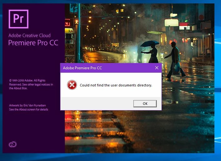

How can I fix this error : "Could not find the user documents directory"

    I've found a way to fix this but I've only gotten so far.. Go to Windows Defender Security Center in your settings. Turn off all of the protections, Real-time, Cloud-delivered and Automatic. Once you have done this run the program and you wont have no errors or problems.

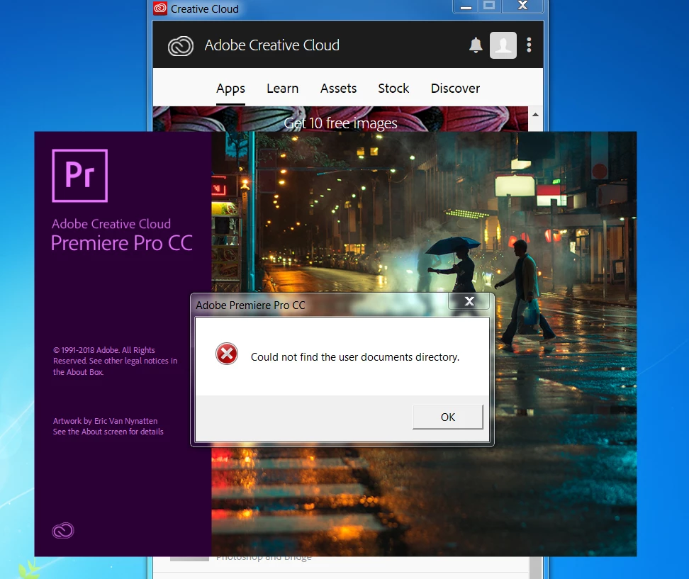

    I'm having this problem..  using Windows 7.  how do i fix?

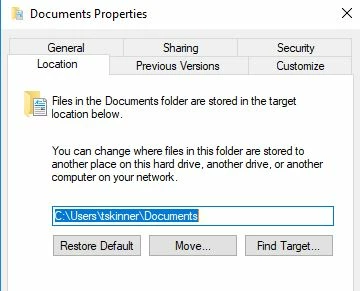

    My school is a Certiport testing center. I isolated my problem.
    Sometimes, when students would test, the Windows path to the Pictures folder or Documents folder would "path" incorrectly (like to the P drive or something). When I repaired that error, it worked without incident.
    May 16, 2018
    That seems like the obvious answer, but how were you able to change the path without being able to access the application?
    I'm either being really dumb or this is unnecessarily complicated.
    TonyaSkinner
    May 16, 2018
    I right clicked the Documents folder. It said some other path. I clicked Restore Default. Just in the Windows explorer/file view, not inside any program.

    I have the same problem...
    Photoshop ok
    Premiere Pro, After Effect : same message...
    I tried all the proposed solutions.
    February 4, 2018
    If you've already done Step 3G below, then also try Steps 3D, E and F.  Try them in that order, and one at a time.
