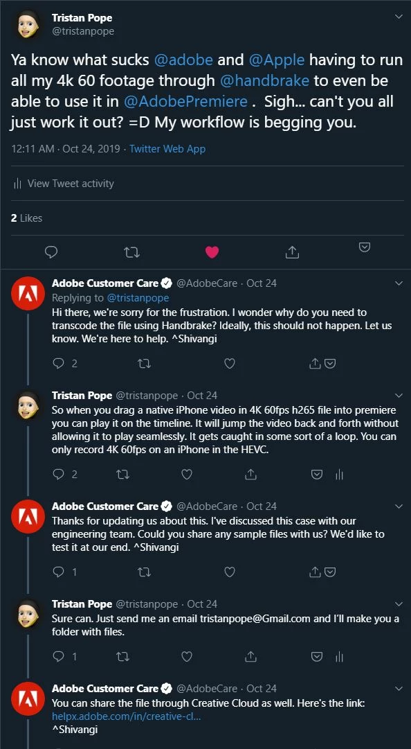

Here is the issue:
The issue is that Adobe Premiere will never play the full clip if you try to move around the timeline. It will always revert back to the beginning of the clip and glitch out. It imports no issus, but playing on the timeline is wrong and glitched, even saving a project with the file in it crashes Adobe quite often. The codec is Apple's H265 which is the ONLY codec you can use to shoot 4K 60FPS. This means I have to run all footage through handbrake to even begin to use it in Premiere, this has been an issue for years. I just wish this response from their twitter was more than damage control and them actually having a solution.
This is where Adobe says this is not working as intended: https://twitter.com/tristanpope/status/1187219976249368576?s=20
This is the example video of it messing up: https://twitter.com/tristanpope/status/1187408078741868545?s=20
And this is the reply I got back from customer support saying it doesn't happen for them, which I find highly unlikely:
Thanks for sharing the file! I have downloaded it and I'm going to share it with the engineering team for testing. I'll update you as soon as I hear from them. ^Shivangi
Oct 24, 2019, 5:34 PM
Thank you.
Oct 24, 2019, 5:35 PM
Thank you for remaining so positive and calm while our experts is working on it. ^Shailesh
Oct 24, 2019, 5:40 PM
Hi Tristan. sorry for the delay in response. We're unable to reproduce the issue at our end even with the sample file you shared. Would you mind contacting our phone/chat support team? We'll need to troubleshoot the issue further by hopping on to a remote session. Here's the link: https://helpx.adobe.com/contact.html Let us know. ^Shivangi
So yeah... any fixes in the pipeline?

When I convert it through Handbrake to be H.264 it works fine.
If I use the raw out of iPhone .mov H265 it will not work.
Video referenced above.
According to Adobe's twitter, this is not what should be happening:
