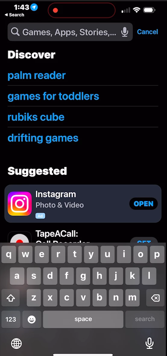

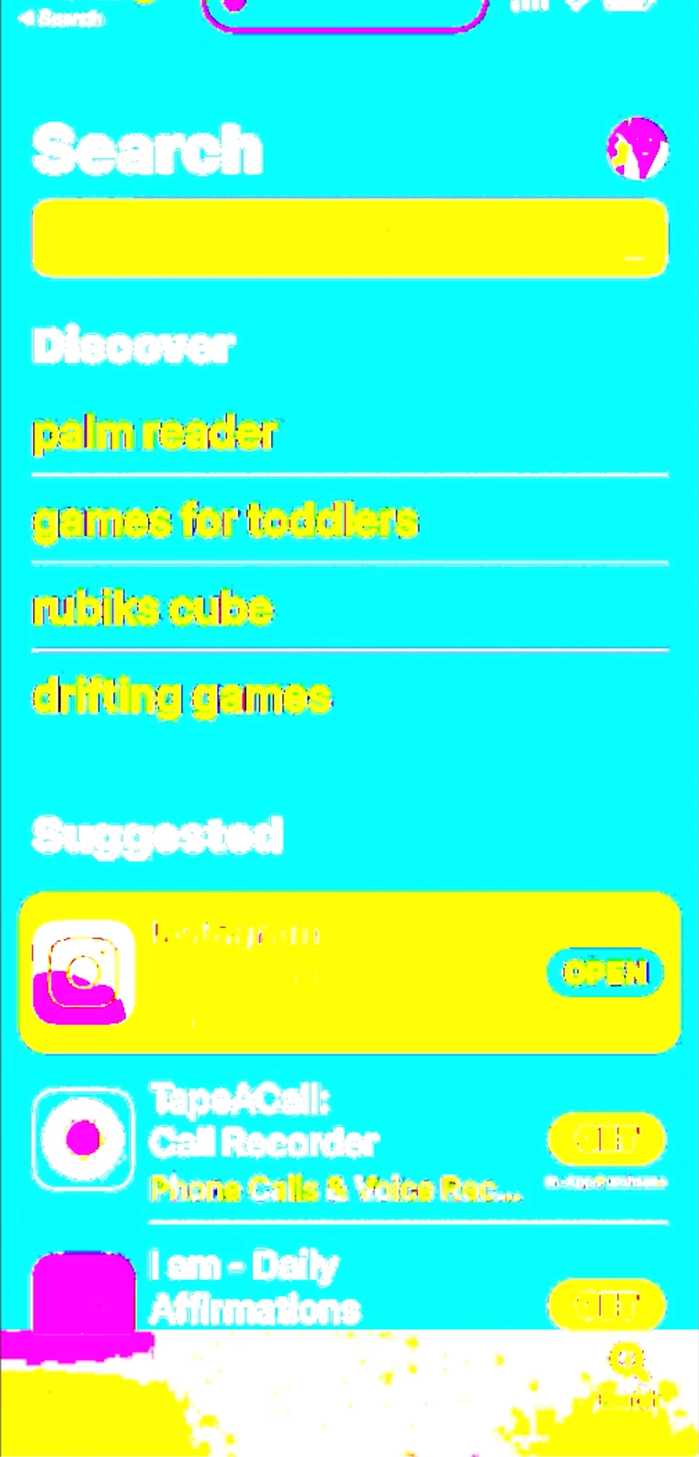

See the two screenshots attached. The first screenshot is how it looks in Premiere Pro (23.2.0), the 2nd is how that section looks after export through Media Encoder 2023.
The rest of the video looks fine. It's only the video footage that I obtained from my iPhone 14 Pro Max using the "Screen Recording" feature that is corrupted.
