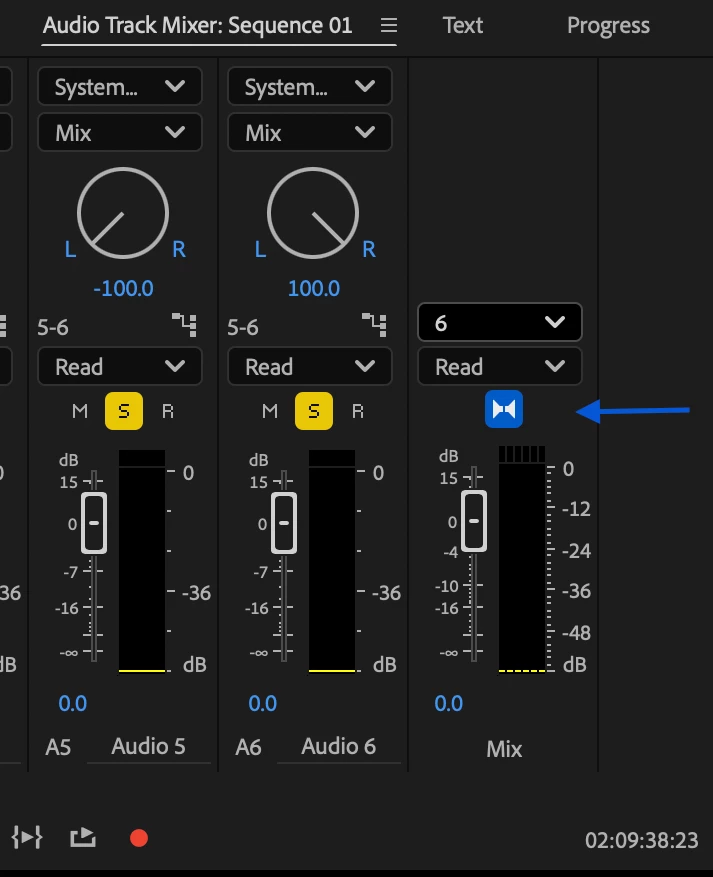

Hi @Gaythorpe - If you’re keeping the channel mapping the same on a stereo system, you’ll need to enable “Monitor All Channels” in the Audio Track Mixer.

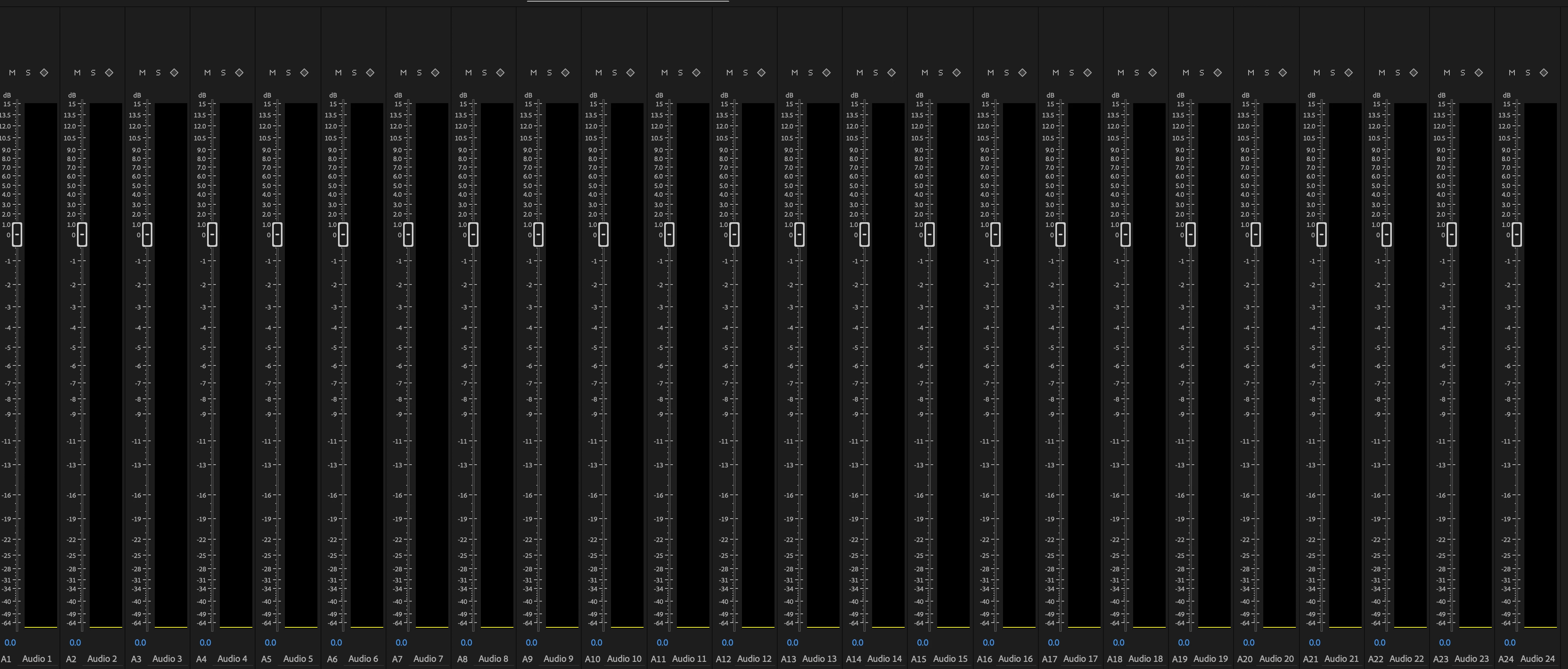

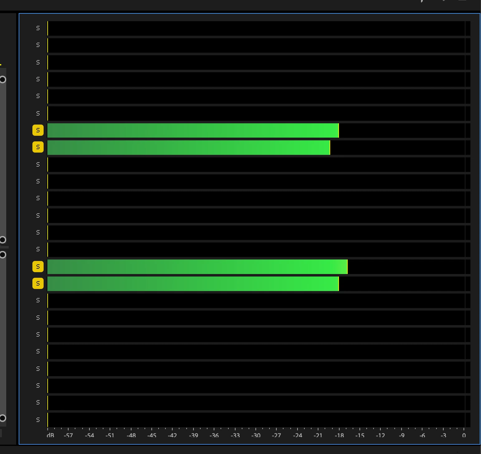

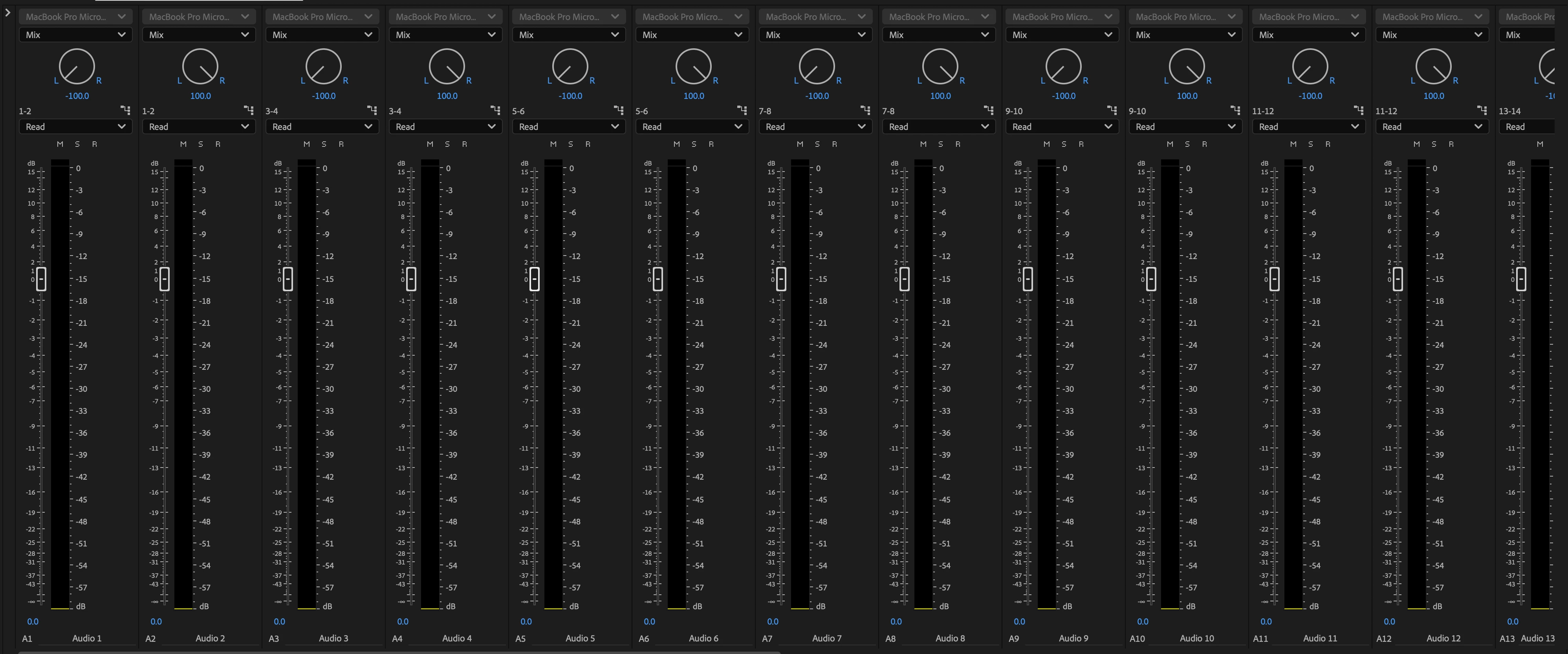

Hi Jamie,
In this instance, I'm using the stereo output from my MacBook Pro. Matt's suggestion corrected the main issue, but as mentioned above, it does seem some functionality has been removed.
Here's the Audip Clip Mixer.
I've configured the sequence to map the first 24 channels of audio to 24 individual outputs, this allows us to make edit's to content containing 22 channels of audio and retain the routing when exporting. I avoid checking files in sequences to avoid the risk of innacurately checking a source file.

Hi @Gaythorpe -  Thanks for submitting your bug report. We need a few more details to try to help with the issue.
Please see, How do I write a bug report?
Let us know if Matt's suggestion helps your issue.
Can you also post a screenshot of your Audio Track Mixer?
What is your setup do you have stereo speakers or a 5.1 system?
Sorry for the frustration.
mattchristensen
May 23, 2025
Try Preferences > Audio > Sum multichannel outputs to mono in Source Monitor
