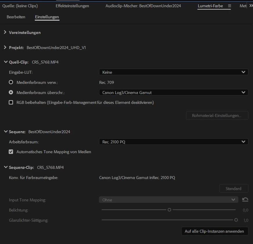

Dec 11, 2024 7:02 PM UTC
Here are the lumetri settings:

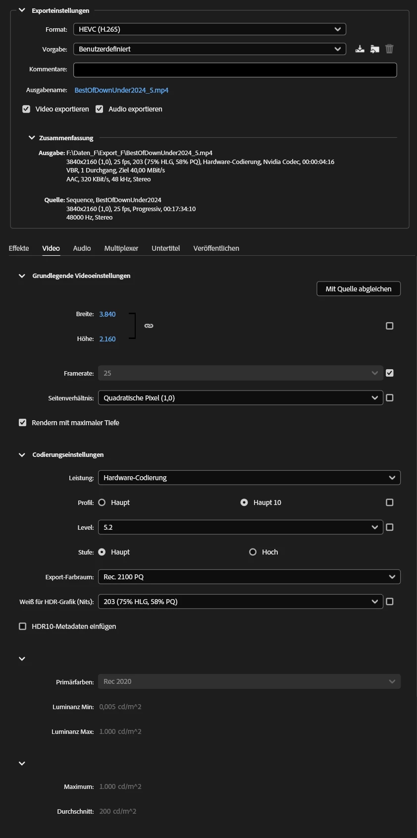

The ME settings are correclty copied from PP. But the preview shows already a flat picture:
IanB_360
Dec 11, 2024 1:16 AM UTC
Hi @traveler6666 ,
Could you further elaborate on the export settings panel from Media Encoder so we can be sure it is matching your settings in Premiere Pro? I suspect it may be a little different do to certain export settings not being set in Media Encoder.
Thank you
Ian
R Neil Haugen
Dec 11, 2024 12:11 AM UTC
That's the right panel, unfortunately, some of the sections are "closed" ... not twirled down ... so we can't see the Project settings, and check if auto detect log, or other things, are off or on.

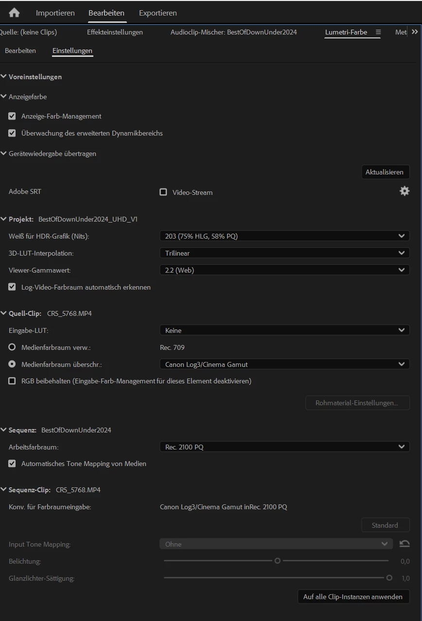

Dec 10, 2024 7:41 PM UTC
I hope it is this:
R Neil Haugen
Dec 10, 2024 12:40 AM UTC
That's the Lumetri "Edit" tab. Where you adjust the colors correction tools.
We need to see the color management settings, in the Lumetri Settings tab. Where you set color management.
