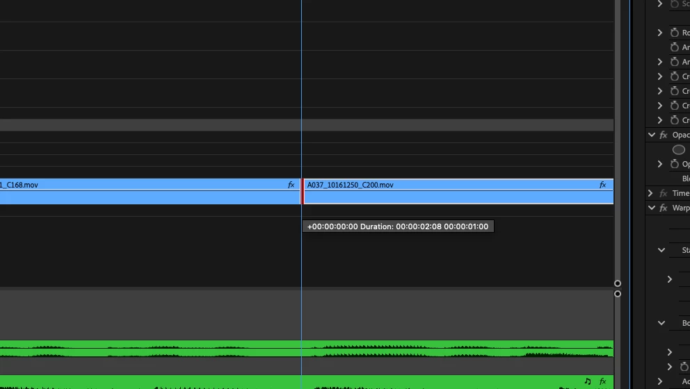

@JamesAOS You mean this cursor thing ? So the duration of these timecodes should also be even numbers (as in 0,2,4,6,8) right?
Still makes black frame on some clips 😞
Thanks for your help

Not sure I understand exactly what your saying about the cursor… If you have two nested clips one after the other each with warp stabilizer and you want a transition between them but you are getting a black frame during the transition when you export it… double click the transition that “joins” the two clips (looks like an X) a duration box pops up. Type in an even number that’s smaller than your current odd duration - so if the transition’s duration is 15 frames, type in 14 hit enter and then re-analyze the warp stabilizer. These steps have eliminated this problem for me entirely, many times a day!

Once you determine that the transition duration is an even number, hold down command and use the cursor to drag the transition so it falls equally onto each clip. Click to re-analyze the clip before and after (you can even try now deleting warp effect and dragging it in again as that is another separate issue). Does this not solve it for you?
