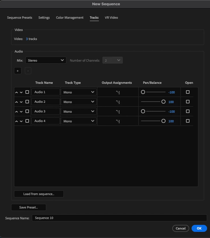

I absolutely HAVE TO have the audio tracks separated when I export, so I can use the sequences later without having the audio mixed together into a MONO track.  Here's how I do it, when I need to separate the tracks, but still want to hear both L/R channels when the vid plays in the timeline:
When you create a sequence, go to the TRACKS tab.  Where it says "MIX", select the STEREO option.  However, where it says, "TRACK TYPE", choose the MONO option for all tracks.  Then, under PAN/BALANCE, pan the tracks LEFT or RIGHT, on every other track.  This way, when you export your sequence, you'll be able to separate the audio, but you'll still be able to hear everything while you're editing.
Once you get this how you want it, I'd also recommend hitting "SAVE PRESET' at the bottom, so you can always utilize this when you need it.

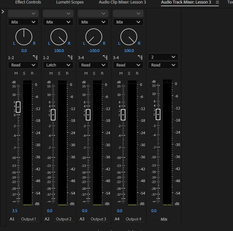

I had kind of a similar problem using Abobe Premiere Pro 2025. The thing is I can see both channels in the timeline. but only one shows on the spectrum/visualizer. I tried many things said in this thread and the given link also tried checking the channels which are 4. while I only need 2. I am working with a multi camera footage but using one audio. I tried left to right and even the other way around. Nothing worked then I went to the Clip Mixer. It didnt help but when I went to the Audio Track Mixer and saw that the Output 1 was on -100 which means eft turned it to 0 and viola. It was back. I hope it can help some of you if not all.

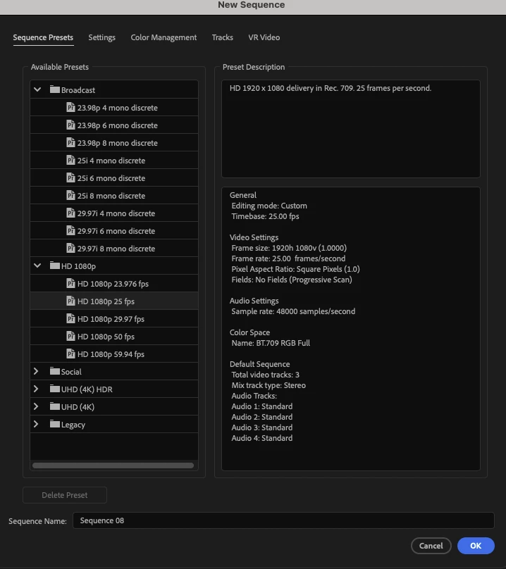

Hi. I'm glad you found a soliution. I had a similar issue with L + R on source audio and only L audio on the sequence timeline. In my case, I hadn't noticed PP initially defaulting to a "Broadcast/mono discrete" preset when opening a "New Sequence". Naturally, consciously selecting one of the  "HD" seqeunce prests solved the proboblem.

I was having this issue today, and after two hours of troubleshooting, I found the solution. In the Audio workspace and in the Audio Track Mixer, each of the 4 levels were the following: 100, -100, 100, -100. I changed them all to 0s and that worked. No idea what I did to change this, or if Premiere decided to surprise me with a problem to solve, either way this solution worked for me.
