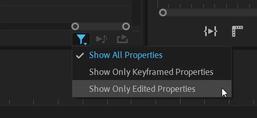

Ann Bens
Mar 4, 2023 12:51 PM UTC
Wild guess:
