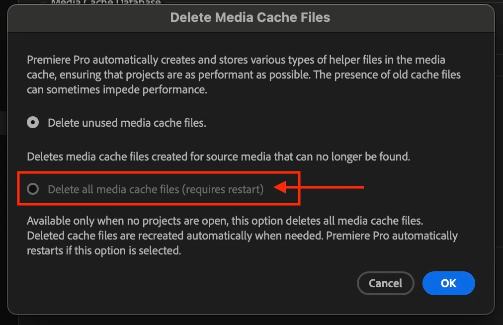

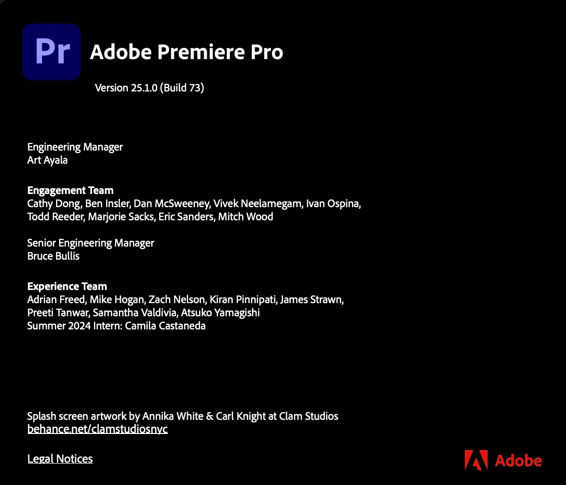

Its Feb 2025 here, and I'm running Premiere Pro 25.1.0 (Build 73) on an iMac 3.6 GHz, Radeon Pro 575X with 64 GB of DDR4 RAM and the Sonoma 14.6.1 macOS.
Just hit the mask tracking issue where I could successfully 'track backward' the mask, but once I tried 'tracking forward,' the progress bar would fill up about 90% and then stop permanently. It was frustrating because I tried all other attempts to troubleshoot. I even tried the "delete unused media cache files" suggested here, but it did not work.
I finally got it to work by selecting the second cache delete option (shown in this screenshot). I closed my project and then selected the "Delete all media cache files (requires restart)" option. Upon opening the problem project and initiating the mask tracking, I was able to successfully get it done.
Hope this helps someone else out.
