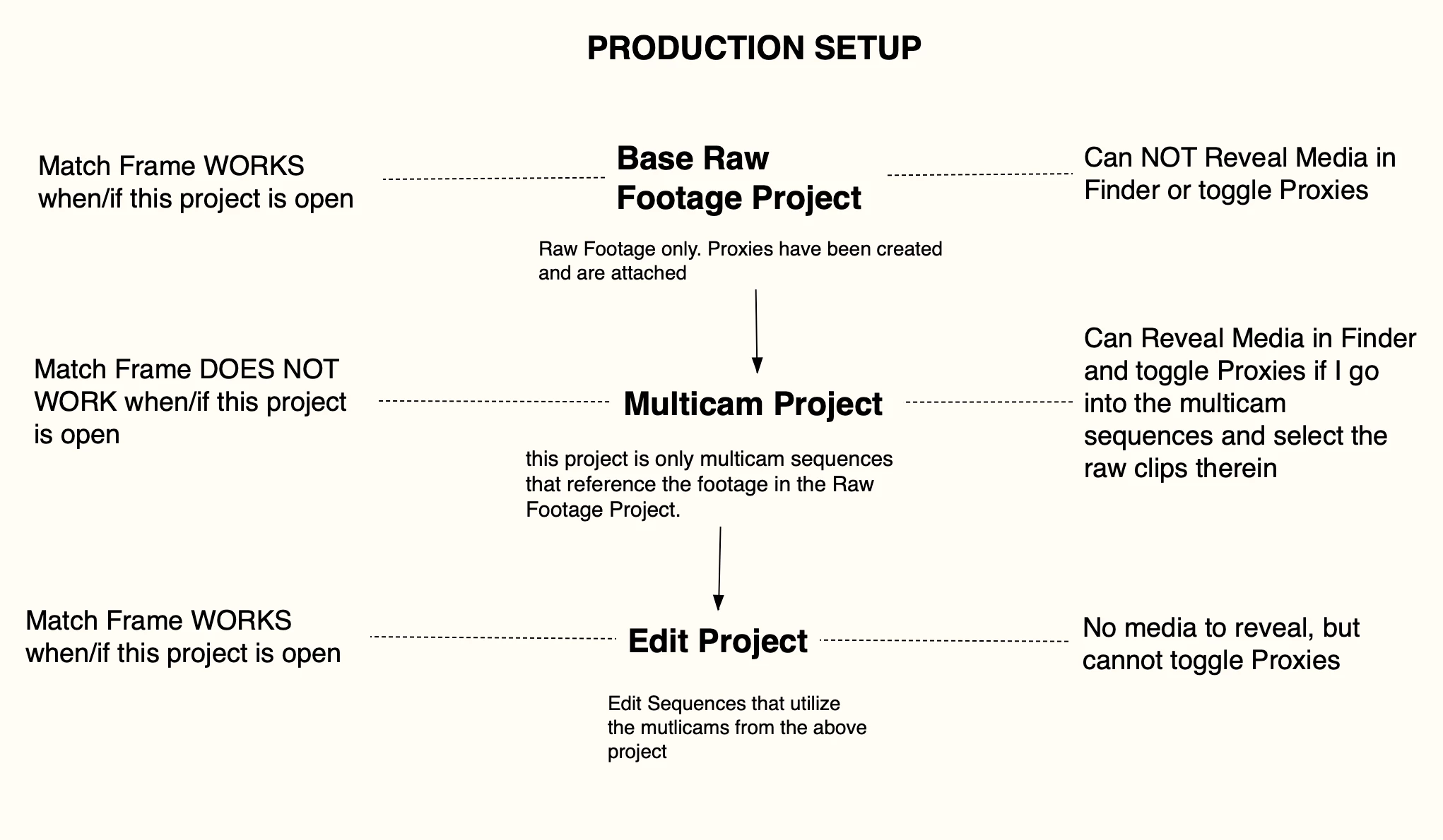

Hi Jamie, just to answer your question directly – yes my media is in one project, my multicams in another, and my edits in another. I made a diagram to make it easier to grasp in case of confusion.
I kept at it and relinked the media in the Raw Footage project, and sure enough the Match Frame behavior has been restored to normal.

Digging further, I think perhaps it is related, inasmuch as the proxies are trying to reference footage that is somehow linked, but acting as if it isn't at times.
I went inside the multicams to get to the source footage. On the timeline of a multicam sequence I right-clicked the media and hit "reveal in finder" and it went straight to the correct file, no problem.
I then hit "reveal in project" which opens up a different project that has all the raw media in it (mutlicam/synced footage is in a different project than the base raw footage. See diagram). Inside this project I could NOT Reveal in Finder. That option doesn't exist. The Link Media option is there as wel, even though the footage appears online – I can view it, edit it into a sequence, etc, although it seems it is using the Proxies to do so because I cannot toggle the proxies on and off. It just stays on the Proxies.
Why the multicam project can reference the source media, while the raw footage project, upone which the multicam project I would think would be dependent on, cannot, I do not know, but I imagine it relates to why I cannot Match Frame sometimes - because sometimes, for some weird reason known only to the Premiere engineers, it is referencing media it thinks isn't there, and other times it's not a problem.
Basically, it seems like my footage is online – I can playback, shuttle, color, and edit footage - but only the proxies it seems. The footage is linked in the Project window, but I can't "reveal in finder" from this raw project. Which is weird, because I can from the multicam project which references this same footage.
Whatever is happening it seems to be a bug in how Productions reference source footage. Here is how I've organized my Projects within Productions. It's weird that in the multicam sequence
