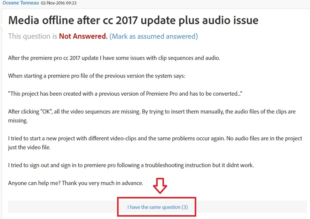

After the premiere pro cc 2017 update I have some issues with clip sequences and audio.
When starting a premiere pro file of the previous version the system says:
"This project has been created with a previous version of Premiere Pro and has to be converted..."
After clicking "OK", all the video sequences are missing. By trying to insert them manually, the audio files of the clips are missing.
I tried to start a new project with different video-clips and the same problems occur again. No audio files are in the project just the video file.
I tried to sign out and sign in to premiere pro following a troubleshooting instruction but it didnt work.
Anyone can help me? Thank you very much in advance.
