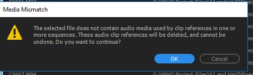

Already started blowing this thing away. Good thing I back up every day:
The message below was received with perfectly good video clips that were working fine. And 2017 definately does not like sub-clips.

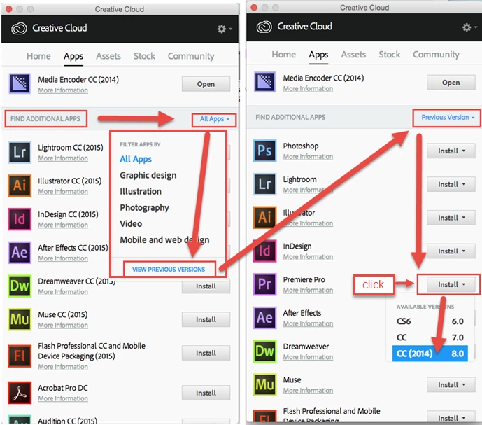

For those who can't downgrade to the previous version, cause there is no "Find Previous Versions" button in the App:
Click the settings tap in the top right corner and click on "search for updates". (Even if it is up-to-date)
The App will restart and the "Find Previous Versions" button will appear and you can downgrade as Ann described.

Its and upgrade, separate install
If I was you finish in 2015.
How to find previous version (old screendump, look for 2015.3)

After about an hour of searching, restarting the App etc. there was finally the "Find Previous Versions" button, which wasn't there initially. Bug? (Windows 10)
So I've finally got 2015.3 installed again. Jippie.

Yeah, same here, no support for AAC audio in video clips... So far it's saying the video clip is missing audio references used in project. Also, a bunch of clips offline in previous project opened with new version.
Starting new project will not give error, just showing no audio stream available in video clip.

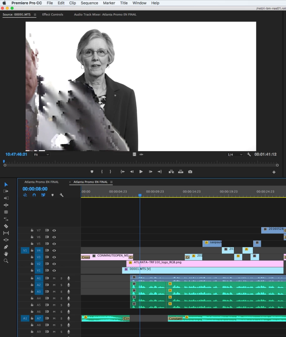

I've been experiencing some glitches today after having updated to the latest Premiere.  Similar to ones mentioned above, but also a few others.  One, I wasn't able to move any clips around on the timeline by clicking and dragging.  Two, none of the keyboard shortcuts were working (even after toggling between different settings).  Three, I had a ghost image appear in my source window (see image) that wasn't associated with the project I am currently working on.  I dug around for a bit, primarily on here, and also spoke to a colleague about my problem.  He suggested I clean my cache which fixed all of the issues I was having.
It's a quick thing to try and it may help some of you out.  Clean that cache!
