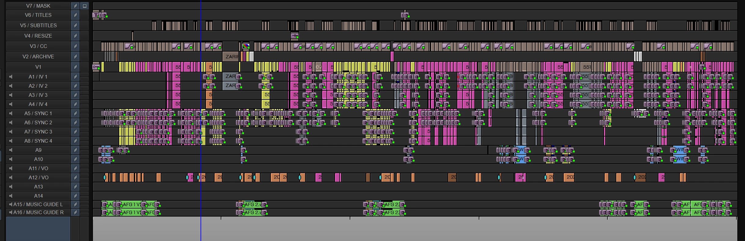

In Avid, I use audio transitions for Level Mixing and for Short audio transitions (softening hard audio edits). Here's a picture of a typical sequence in Avid for a fairly simple edit.
Scenario 1 - Level Mixing
In Avid, I mix my sequences using clip Levels and placing dissolves (transitions) on through-edits.

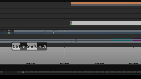

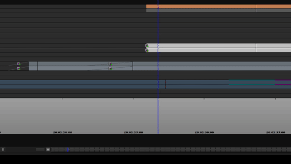

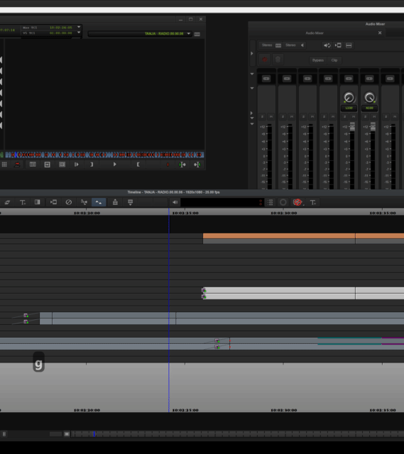

- I have a bit of music on A9/10 (or a bit of sync on A1-4) that needs to dip,
- I add a through edit on A9/10.
- go to the mixer to set the level after the cut.
- I move the cursor to where I want to start the level dip, fix the level in the mixer and
- Click Shift+3 which I've mapped to Fade to cut.
I can slow down or speed up the fade in two simple operations:
- move the cursor to where I want the fade to start and
- click Shift+3 to overwrite the existing fade with a new one.
With my Razer Naga mouse, this is an incredibly swift and streamlined process.
I can the positions of the mixes very quickly too. If I'm dipping for a bit of sync and I want to move the sync up a bit, I just go into trim mode (The [ key on my keyboard) on A9 and A10 and move the match cut.

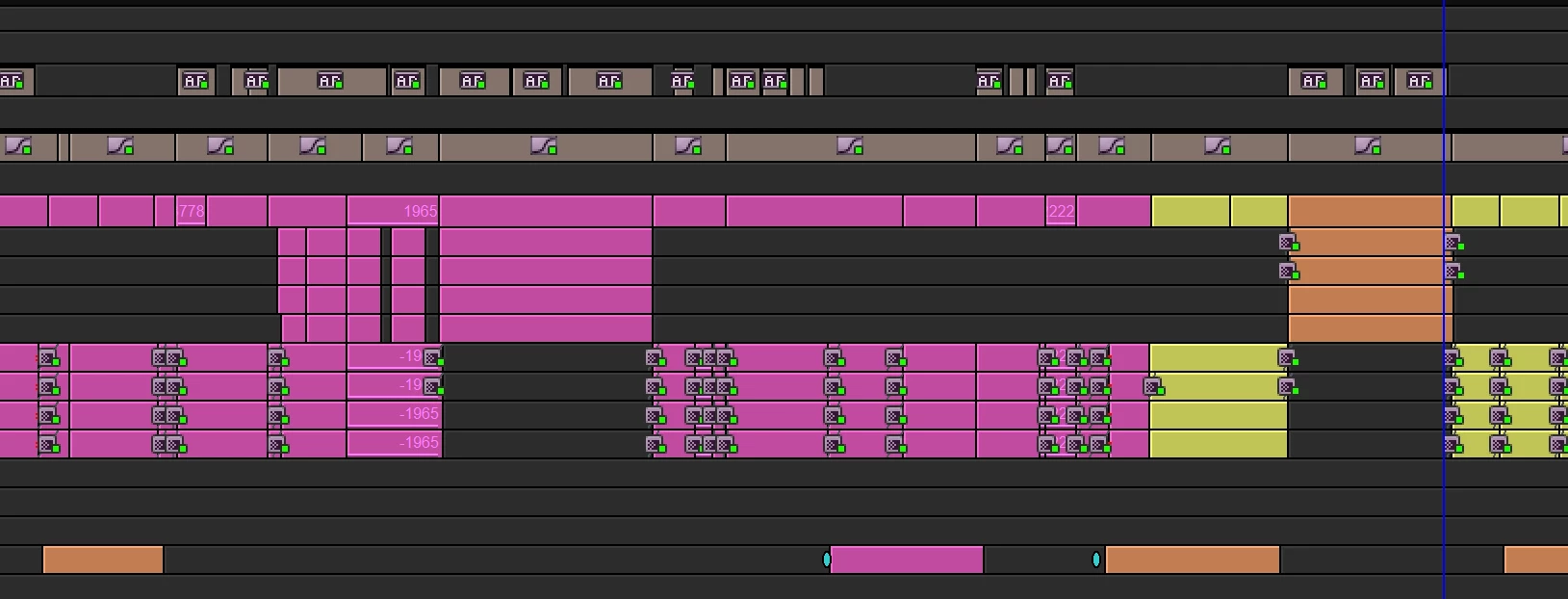

Scenario 2 - Short Transitions
I use short transitions to soften audio cuts in audio. Say I've got a cut between two bits of interview, but there's a short pop or a difference in background noise.
- In Avid, I select my sync tracks (say A1,2,7,8)  then I click Shift+1 on my keyboard. This maps to Add Quick Dissolve.
- This brings up a dialog box with a duration in it, and the textbox with the duration is already selected, so I then tap keyboard 3, or 5 or 10, or wahtever to set the audio mix to the appropriate number of frames frames (the precise count depends on the precise sound difference I'm trying to soften).
Assuming I've got the right tracks selected, this is 3 button clicks to get a dissolve on the four tracks:
  • Shift+1, 3, Enter. Done!
If I haven't quite got the dissolve length right, I just go through exactly the same process again with a different frame count and it overwrites the existing transitions:
  • Shift+1, 5, Enter
With my mouse with a number pad (Razor Naga), I can do this without ever touching the keyboard.
I also use this technique for dealing with starts of words which strictly lie between the frames. Sometimes I need to add a 1 frame edit to really get the start of the word.
Quick overview. It's fast, and very un-fiddly.
