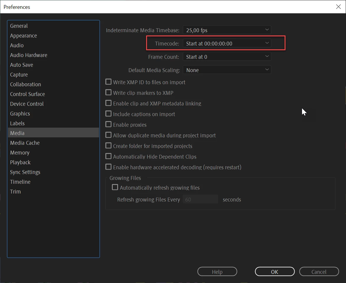

Ann Bens
October 31, 2019
Actually its not a workaround but a preference setting.

dbeaty2Author
October 31, 2019
Thanks Ann great work around.
