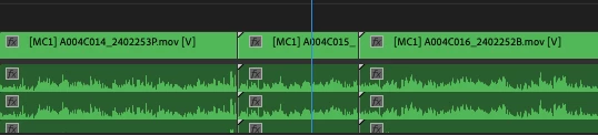

I am encountering a bug with Multicam source clips when they are cut into a timeline. I've attached three screenshots to illustrate my issue.

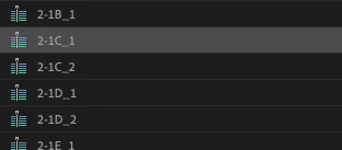

I have synced multiple camera angles to create multicam source clips, and given them custom names according to the scene and take (image 1). However, once these clips are cut into my timeline, the custom names disappear, and the only name that is displayed is the filename from the source (image 2)

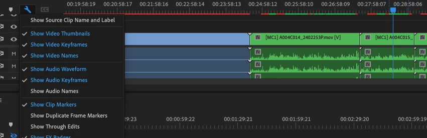

It seems that there is an option in the wrench menu of the timeline to "Show source clip name and label" (image 3), however even when this option is unchecked, Premiere Pro still does not display the custom multicam clip name in the timeline. This is an beyond frustrating- editors need to be able to look at the clips in their timeline and know exactly which scene and take they are looking at.
A note to Adobe's engineers: please do not suggest some convoluted work around- this is clearly a bug and should be very simple. It does not make sense why the "show source clip name" option doesn't work for multicam clips. FIX THIS PROBLEM.

I hear ya on this one.  Not that it helps, but we're aware of this.  It is currently designed this way on purpose:
once these [multi-cam] clips are cut into my timeline, the custom names disappear, and the only name that is displayed is the filename from the source
Multi-cams are designed to not show their source name in the timeline.  They show the source name of their selected angle.  That way, editors can see the name of the angle that is currently in use at that moment in the timeline, rather than the multi-cam name which may not be as descriptive.  If you make a series of cuts - Acam | Bcam | Acam | Ccam | Acam - each adjacent clip here will display as the same name if showing the multi-cam source name.  Showing the clip name of the selected angle displays a clear reference of what actual media is being used, and the name will change per clip in the timeline to reflect this in the same example above, even though each clip references the same multi-cam.

there is an option in the wrench menu of the timeline to "Show source clip name and label", however even when this option is unchecked, Premiere Pro still does not display the custom multicam clip name in the timeline.
Correct.  This option allows you to have your timeline label colors and clip names reflect the project source names of the used media in the sequence.  When this option is off, you can set local label colors and names on a per-clip basis in the timeline.  You can then toggle this on and off for different label workflows. For example you could have a dailies workflow that reflects the source labels which will display in the timeline (e.g., non-circle takes are green, circle takes are red) and also have a parallel timeline local VFX workflow (e.g., yellow clips are shots that need VFX, white clips have been turned over, and blue clips have their VFX work complete).  Toggling the Show Source Clip Name and Label option allows you, or others you are collaboration with, to switch between these two workflows without one intefering with the other.
That said, multi-cams do continue to work in the same way as described above in this scenario.  They will display local colors when assigned, but will not display their source multi-cam name, and they will not show a local name in the timeline when Show Source Clip Name and Label is off.  They will always display the name of the active angle within.

The recommended workflow is to also name your source media, so for example...
  • For multi-cam 2-1C-1
    • A001C001_240425AX becomes 2-1C-1_A
    • B001C001_245698CV becomes 2-1C-1_B
    • C002C001_240138EO becomes 2-1C-1_C
I don't consider this convoluted to be honest, just a part of the dailies labeling process.  I've done it this way on many projects.  With this workflow, you you get all the scene (and camera) information you're looking for in the timeline when using multi-cams.  We go farther, in fact, adding tags like _MOS or _48FPS to the source clips so that we have confirmation directly in the timeline that a specific angle shouldn't have audio, or was shot overcranked so we know exactly what math speeds it back to real-time if necessary.

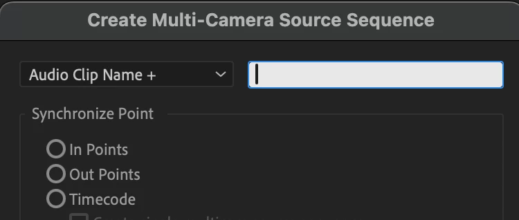

I feel like there’s a simple solution to this problem that no one has mentioned yet.
When you create your multi-camera source sequences in the Create Multi-Camera Source Sequence window, switch the name type from Video Clip Name + to Custom.
This custom name will then display in the timeline instead of the source files.
October 29, 2024
Just did a little extra digging into this and can confirm that when you select Video Clip Name +, the clip in the Timeline will only display the underlying source clips in the multicamera sequence.
However, if you select Audio Clip Name + or Custom, Premiere adds a single line of code to the clip that switches it from displaying the source clip names to the multicamera name.
It would make much more sense if this were a setting that could be toggled on or off, rather than being set and irreversible at the point when you create your multi-camera source sequences. The names of these naming options don’t really indicate how they will ultimately behave in the Timeline.

@SoundW0rm93 Setting Multicam to Audio Clip Name allows you to change the name in both Project Panel and Timeline.
As audio is often named after scene/take this can be quite a time saver.

December 20, 2024
The Audio Clip Name option will name the multicam based on the audio clip, but it will also display the multi-camera source sequence name in the Timeline rather than the source clips.
If you click Timeline Display Settings (the wrench icon) and enable Show Source Clip Name and Label, it will automatically display the name of the multicam clip as it appears in the Project panel, even if you update it later.
This behavior is the same for the Custom option. Only the Video Clip Name option will display the source clip names in the Timeline.

Yes.  You wouldn't even have to save and re-open to see this reflected.  This will update in real time as you rename your sources.  Note, however, that you will need to be sure and enable Show Source Clip Name and Label.  When you built your multi-cams, the source clips that were cut into the multi-cam sequences were assigned their source names as their local names in the multi-cam sequences.  So if you have Show Source Clip Name and Label off, you will see the local names, which match the original media file names.
