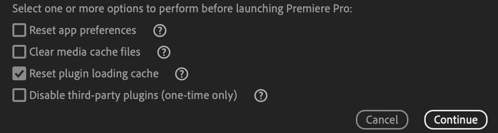

I have been running into the same or similar issues on a new Mac Mini M4 Pro fresh out of the box, as described here. When launching Premiere (both v 25.1 and v 24), the loading window briefly displays as mentioned, then the system crashes while in mid initialization. But I now suspect legacy effects/3rd party apps or plugins over the iCloud issue.  As Jamie Clarke suggested I went and did the “hold down shift thing” while opening Premiere and select all of the checkboxes. To turn them all off. After a warning list regarding 20 missing legacy transitions and filters PR Pro 25.1 seems to be up and running again. I need 24 for school, so I’m going to try that version as well.

Yes I am also running 24.6.4. And hold down shift when launching then "dissable third-party plugins" √

Have you tried holding down shift while opening Premiere and select all of the checkboxes?
