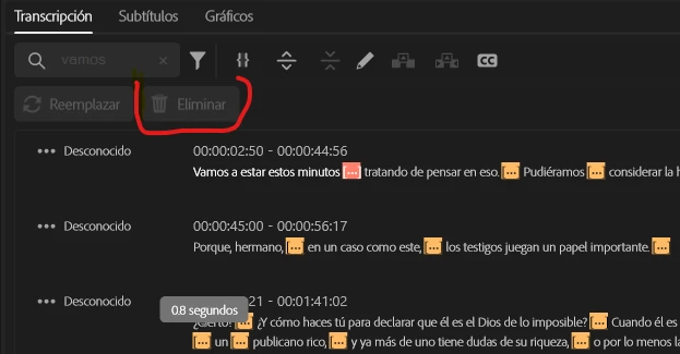

No se activa la opción de eliminar cuando intento eliminar las pausas
¿Me pueden ayudar? No se porque no me deja eliminar las pausas, tengo la ultima version de premier pro y tambien la beta. Adjunto imagen

Hi all,
you can only delete pauses or fillers when you are in a (dynamic) sequence transcript. It's not possible to delete pauses/fillers in a source transcript because you can't "cut out" bits of the source clip (because then the source clip would be chopped up into different sub clips – which is not doable unless you put the clip into a sequence). In a source clip you can only search and filter for pauses/fillers/words but you can't do any editing actions other than text correction. So, if you want to remove all pauses etc, you have to put the source clip into a sequence first and then work on the sequence transcript.

Hi @Trebreh sb
are you trying to delete a pause from a source clip transcript or from a sequence transcript? How it works is that pauses can only be deleted from dynamic sequence transcripts (that means a sequence that contains of transcripts from previously transcribed source clips).
If it's not working for you in a sequence transcript, could you please share a screenshot so I can investigate more?

@29527238 @danielr72276698,
This is a bug in 24.0 and 24.1. And I just confirmed it is  present in Beta 24.2.0.54. The "Delete" button is missing in Source view with a source transcript and in Sequence view with a static transcript. And you also see the problem if you nest a Sequence with source transcripts in another sequence.
But it works correctly if you are looking at a sequence with source transcripts. That workaround works for some, but all circumstances. Give that a try and let us know.
I was hoping for a fix, but the problem is still present in PR Release 24.1.0 and not fixed yet in the Beta.
