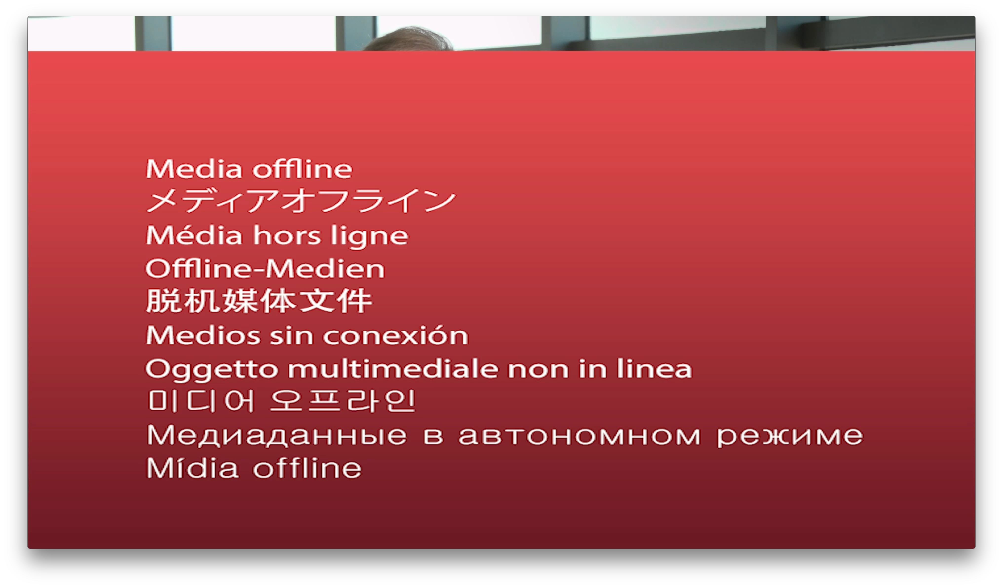

Stefan, and all users involved: has a solution to the original problem arisen?
To be specific, I'm having the issue where captions in Premiere will not export through Adobe Media Encoder. Instead I get a "file offline" notification where captions should be.
My bug may slightly differ from the original in that the captions were brought into Premiere as SRT files, then positioning, size, appearance, and timing were tweaked from there (side note: I'd love for this to be more intuitive as well).
Exports from Premiere work fine, but as I need to export multiple captioned sequences, this is a big slowdown on my workflow.
Attaching photos for reference. Adobe staff, if this issue is slightly different than the original, I can submit it separately.

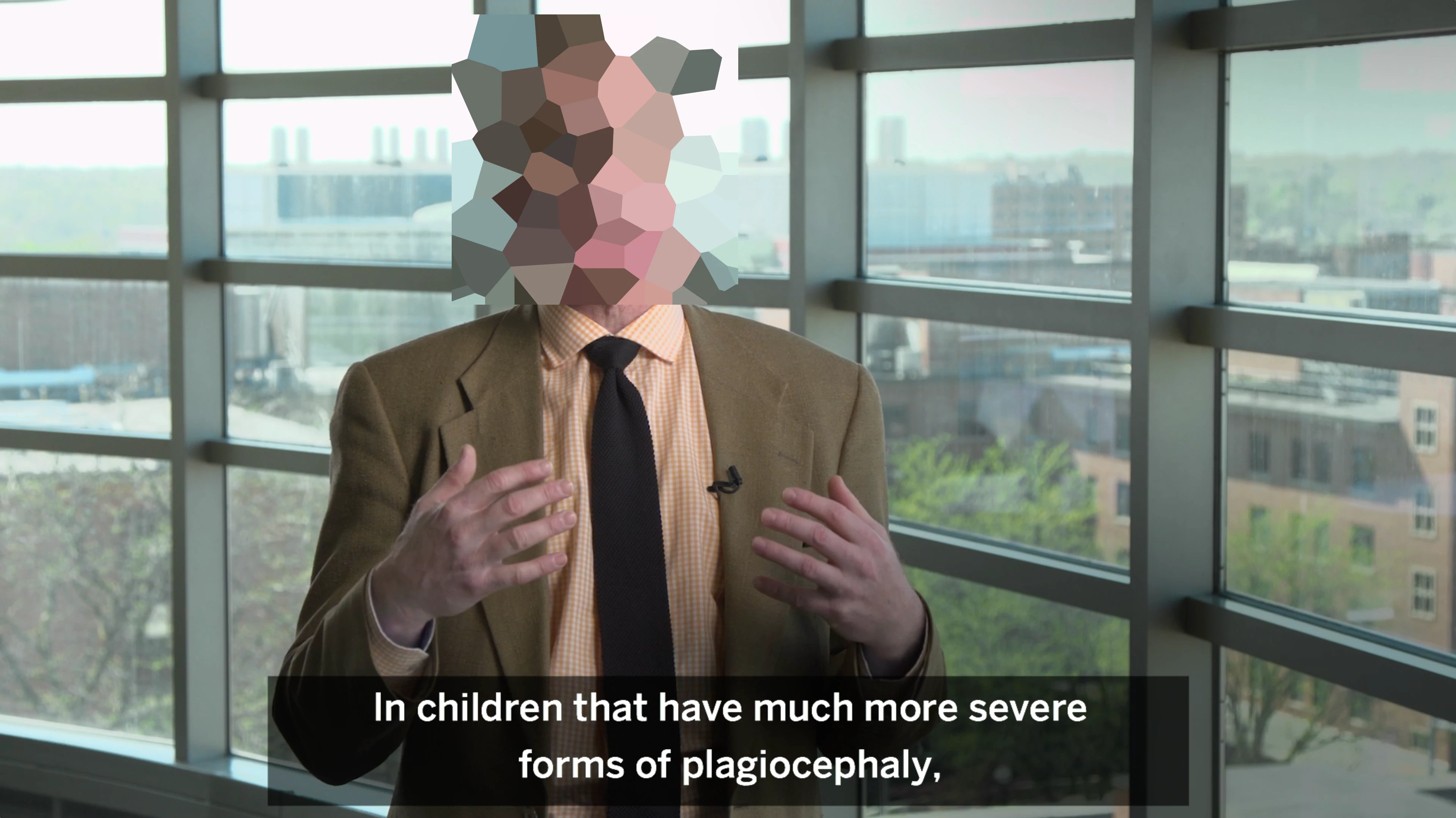

Hello Jarett,
Have you checked that the toggle caption is set in your exports settings ?
You should select "burn into the video" in the export options
Look on the picture attached, and tell me if it works.
