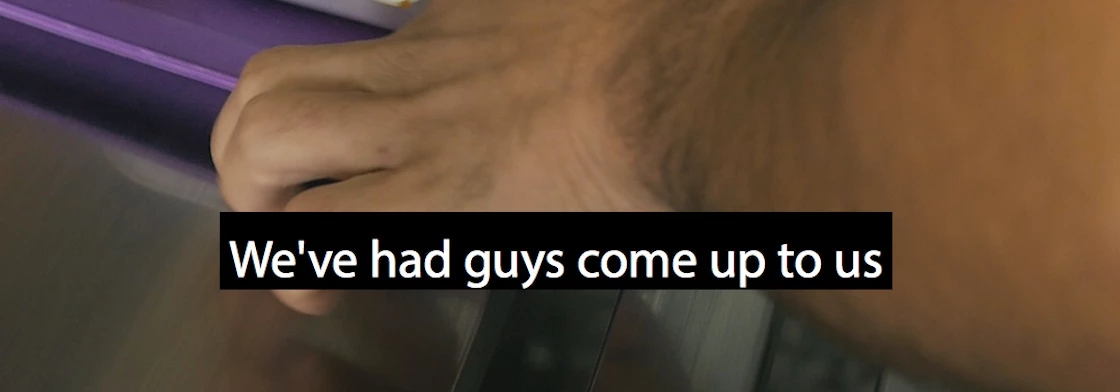

Open captions text not centre aligned with background
Just trying to do some simple open captions (white text with black background) and the text is not in the centre of the background box, which looks pretty bad. Can't seem to change it as all controls change the text and background as one. There's got to be a simple solution...? Any help much appreciated.

Known issue and no fix yet. I know of no workaround. I reduce the opacity of the background box - sometimes all the way off.
Problem if burning in; If your exporting srt, it won't matter.

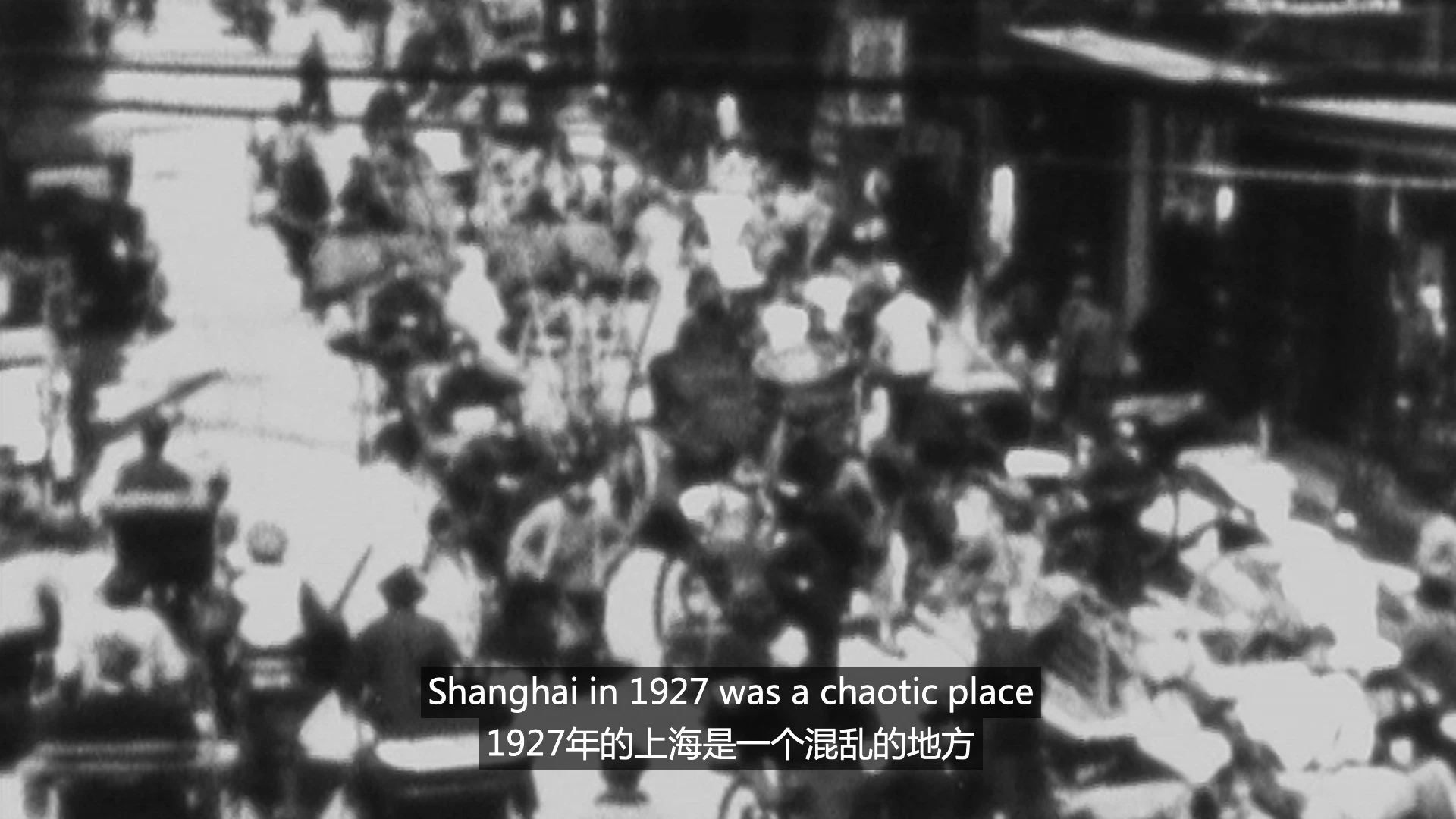

Hey guys, it seems there still isn't a workaround, but I have found a font that miraculously centers the text, for some reason. The font is called Microsoft Yahei, and it's an okay looking, pretty standard font. Still annoying you can't choose your own font but I think this works well enough.

This font does center the text vertically in the background box. But when adding any edge, even "1," it goes back to the bottom of the box. It is improved by setting Line Spacing to 100 (instead of the default 50).
