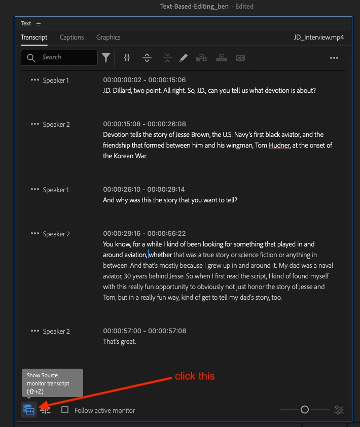

The 'Correct' answer here did not solve the problem for me, but after some searching around, I found this little icon, which added the elipses back to the speaker names •••Speaker 1

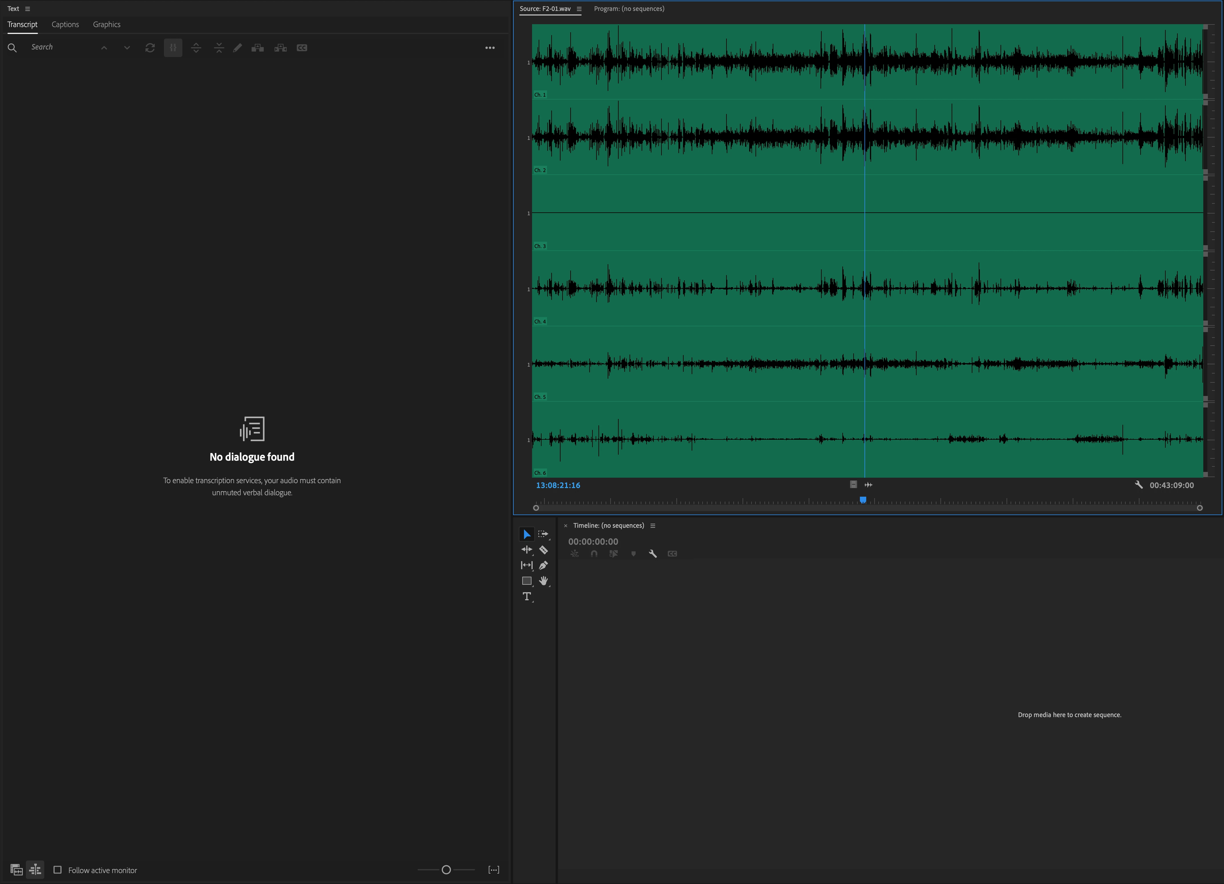

I'm now having a similar issue with attempts to change the speaker names. After transcribing the source audio, I am able to see the transcription when I bring the audio into a timeline, but I am unable to see any transcript when looking at the audio in the source monitor. I've attached a screengrab showing the transcribed audio in the source monitor, and it says "No dialogue found" in the Text window. I closed out of any sequences because then the transcript will populate, but I still will not be able to change the speaker names without going to the source.
I closed/opened the program and Re-Transcribed the source audio to see if that would fix the issue but it does not.
Version 23.6.0 Beat Build 13
Apple M1 Ultra Studio, Ventura 13.3

Dan,
You have deselected "Follow active monitor" and are in the sequence view. Click on the Source Monitor view. Note that the source media transcription will only transcribe audio track 1 (by design in the current implementation) - but it may process all the tracks (I think that should be considered a bug).
If your dialogue is not in track 1, see the workarounds in this feature request:
https://community.adobe.com/t5/premiere-pro-ideas/audio-track-selection-for-source-media-transcription/idi-p/13828019
FYI, I prefer keeping "Follow active monitor" on, because then I can pick what I want (source or sequence), then just switch to the transcribe tab.
Stan
June 7, 2023
Very helpful thank you. For anyone else looking for the "Follow active monitor" checkbox it's in the lower left hand corner of the Transcript window.
