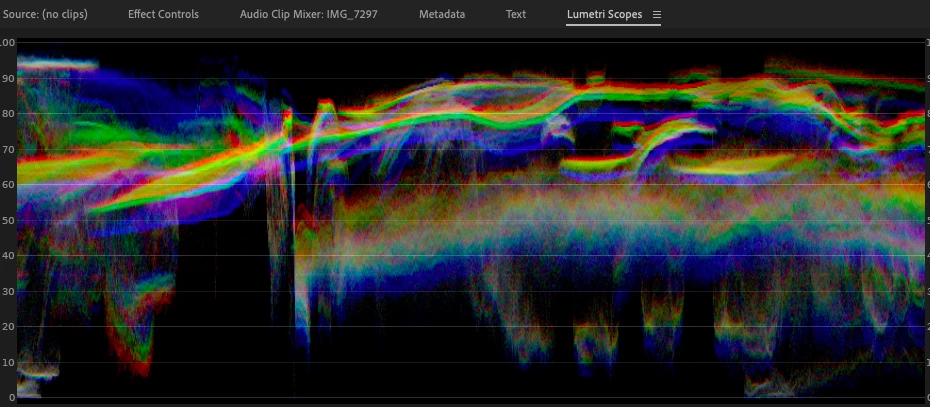

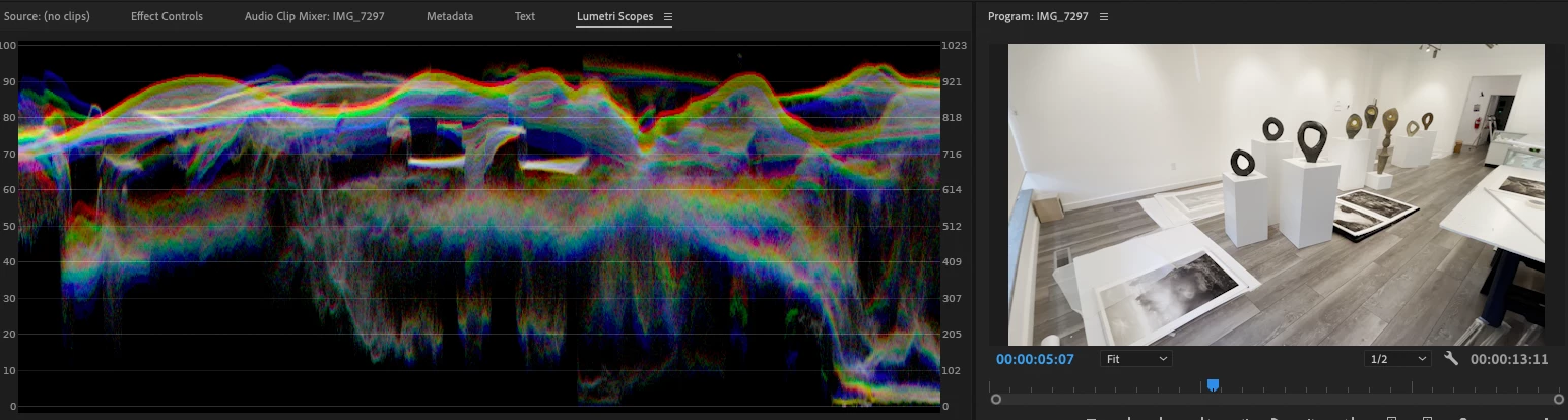

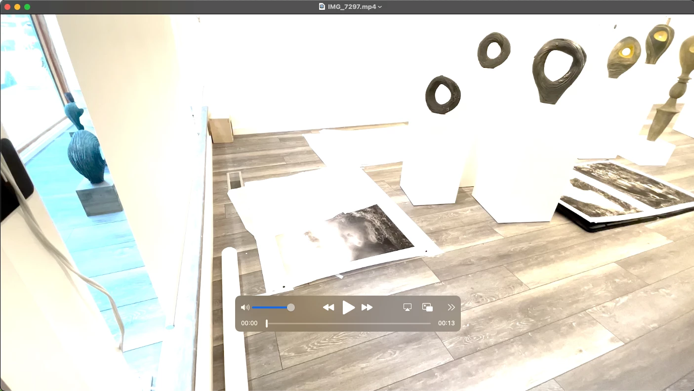

I'm working with v24.5.0 and having an issue with my output being 1-2 stops brighter than the original footage.  I've reset the program but still getting the same result. The only way I can get a good (but not really accurate) output is to reduce the exposure or drop the white point in curves.

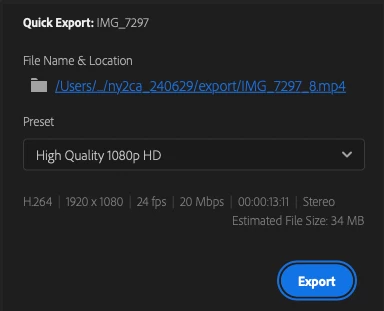

And then exported with an SDR/Rec.709 export preset?
As that all would combine to create what you have described. Well, it's one way of getting to what you've described, at least.
Where, if my guesses are correct., actually setting the CM correctly would get a different result ... auto detect log and auto tonemapping on, and if working on a Rec.709 sequence, using a Rec.709 export preset.

Thank you for the suggestions.  I imported the Quicktime file into a different sequence and the export worked perfectly.  Thanks again.

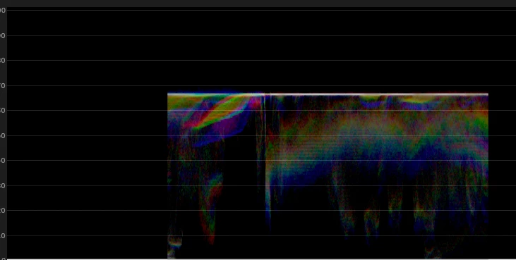

I did import the exported file, and it appears that the values are being crushed.  I've looked at all my settings and cannot see where I might have affected the default.
