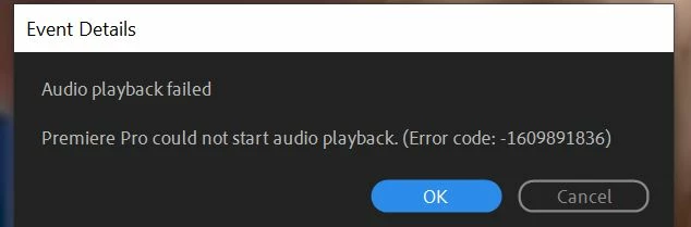

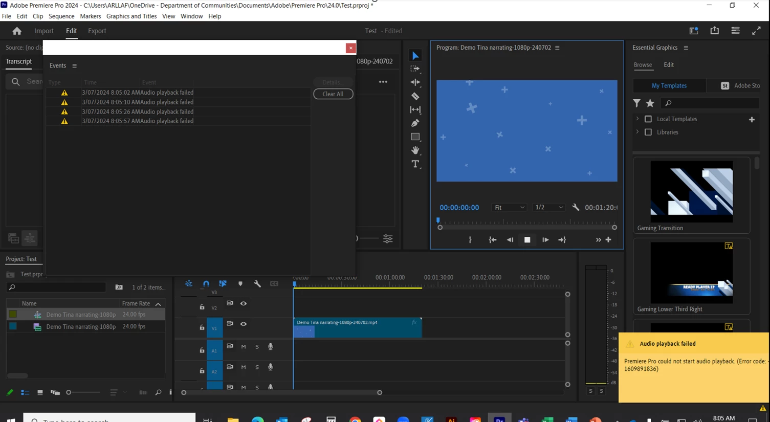

P: Audio playback failed error code: 1609891836
Any video I upload gets the 'audio playback failed' error message (and says Premiere Pro could not start audio playback errror code 1609891836) when you click play. The app doesn't recognise audio in any of my videos and wouldn't even play. Please see attached image. Can you please help me troubleshoot?

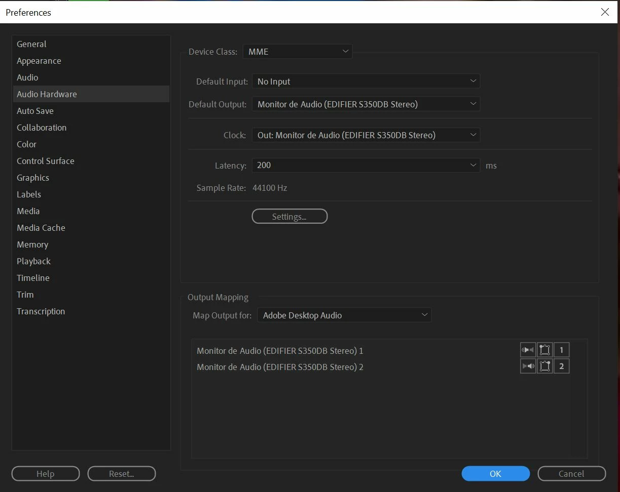

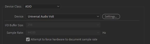

Sep 11, 2024 6:35 PM UTC
"Ive tried everything mentioned in this thread"
Did you clear your Media Cache and let it rebuild?  Is the drive with Media Cache have sufficient space?  If there is not enough free space (if the drive gets full) it will affect playback.
According to those screen shots you posted, If I were you I would uncheck "Attempt to force hardware to document sample rate" and see if that helps.
