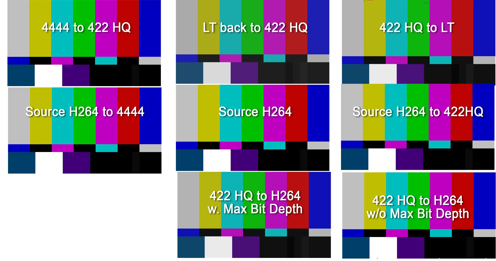

Here is what we tested: Whenever we encode using maximum bit depth from ProRes 422 HQ on PP 13.1. there is a "gamma shift", making the newly encoded file looking washed out/too bright. It's reproducable, at least for our 3 machines. However, the new file had to be rendered, apparently if you just make a 1:1 copy from ProRes 422 HQ to 422 HQ or even to ProRes 4444, Premiere just "copies" the frame information without encoding. If you change the resolution, put a watermark or TC in the picture or change the codec, all while having the hook in "Use maximum bit depth", the gamma shift occured.
It did not happen, if the source file was H264, DNxHD, or even ProRes 4444. It id not happen, if we hadn't marked "Use maximum bit depth" in the export window.
It did not happen on PP 13.0.
It did happen, if the source was ProRes 422 HQ or Prores LT, Prores 422 or Proxy, and we had marked "Use maximum bit depth".
