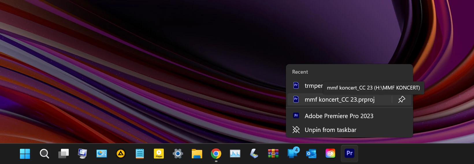

STUDIO29KAuthor
May 11, 2023
Dear Kevin,
I don't have the import option when I open Pp, it's gray, I have options like, new, open project etc...so I don't IMPORT anything... I just OPEN the project from version 23.3 in pp 23.4... to clarify the concepts a bit. ... I simply open the folder where I have a concert, for example, and click on concert.prproj or from the pp icon on the taskbar, right-click and open the project, so I don't IMPORT anything, I just open it (I see that importing and opening look the same with you) ... and yes, the multicam doesn't work, checked everything on the new system (I have an image of the win 11 system with all programs, the latest updates, without the premiere, which I return in 20 seconds) and after that I install the new Pp 23.4 and the multicam still doesn't work.
I have the image system just because of those things with Pp... and not to forget, I use Pp from version 1.5... thanks for the help and a message to the Pp engineers to release at least one iteration of pp in the next 7 years without errors and problems... thanks ...I use Win 11 for workstation
