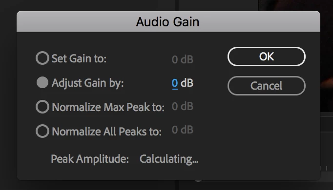

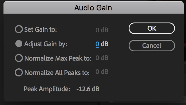

helpful_scientist5EB7
Oct 30, 2017 7:36 PM UTC
I have discovered a "for-around" for this. And it might perhaps help Adobe solve it.
  1. Select the clips or clips.
  2. Right click on the clip or clips and select Audio Gain... (or via the menu)
  3. HERE IS THE KEY: At the bottom of the dialog, there is a line that reads: Peak Amplitude:   Calculating... You must wait for the word "calculating" to be replaced by a number.
  4. When Calculating... Is replaced by a numeric value, such as -12.6dB, you can select the radio button you want and click ok.
  5. Audio is now normalized!
I have a 100% success with this method. Sometimes it's a long wait, especially with a really long clip that I just imported.

Oct 27, 2017 3:04 AM UTC
I've been having the same problem with normalize on Version 12.0.0 (Build 224).
What I've found is that when I bring up the Audio Gain window there is a line at the bottom of the window that says Peak Amplitude: and either a dB value or the word 'Calculating'.  If I enter my value and click OK while the Peak Amplitude is Calculating I get all max values throughout the clip (white block).  If I wait to click OK until after a dB value appears then normalize works just fine.
I suspect that this bug doesn't show up if you're on a fast machine that calculates the peak values very quickly and completes before you hit OK.  I also suspect that the Adobe developers and testers have very fast machines.
Hope this helps.
