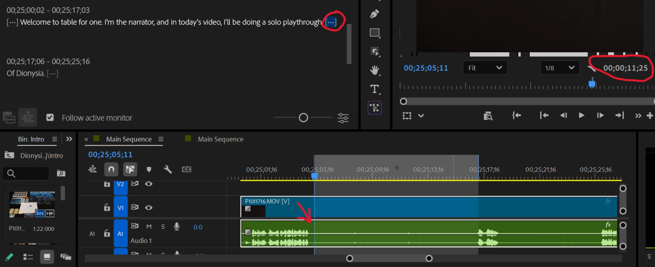

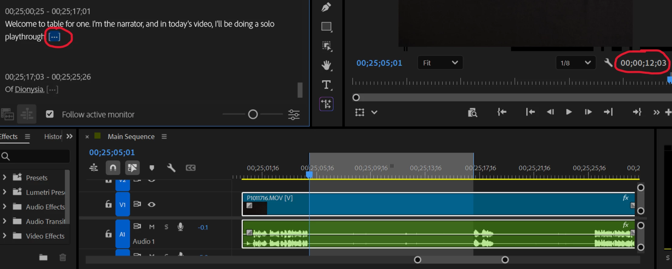

    I managed to grab some screen captures posted here. I took a project that was transcribed before the update and selected a pause for reference. Then I created a new project, imported the same source file and transcribed it (post update), and you can see the pause is way off.
    Also, for reference, I have indeed tried opening a brand new project file with a new sequence (after fully clearing the cache), and I get the same results.

    Above: This was transcribed before the update. Works beautifully!
    Exact same source file, transcribed after the update. A huge pause is introduced that must be edited out manually. Each of my videos has hundreds of these.
