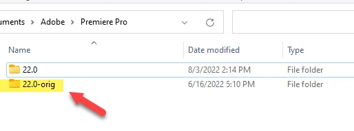

OK, it was a long shot. Try restoring your preferneces to default. The way I do it is I navigate to this folder:
%UserProfile%\Documents\Adobe\Premiere Pro
And then I rename the folder with the highest number, like below:
If that works, then it was something with your prefs, if not, you can delete the newly created folder and set back to the original prefs by renaming it to, it's original name. You can also go back to your original prefs temporarily to perhaps get screen shots of the prefs screen, so you can reset quickly using the new prefs.

Heya, thanks so much for this. So to confirm; you rename the (highest value)folder to something that adobe wont recognise. This will presumably result in premiere resorting to default prefs. If that works then I need to change my prefs manually within the program. If it didnt solve the issue, then I just rename that prefs folder to its original name and premiere will then revert back to the prefs that I was using before?

Yes, you can leave that folder open in Explorer and you'll see the new folder being created as PP starts. If nothing changes you can delete that newly created folder and rename you prefs folder back to what it was.
