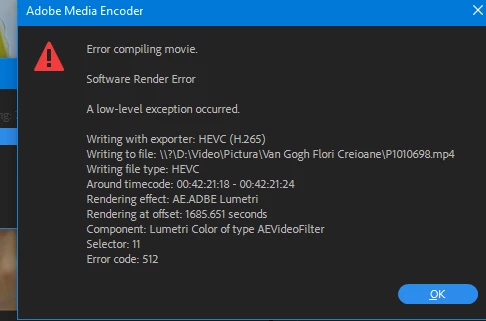

Trying to export video to DVD format (MPEG2-DVD).. It starts to render video "normally" up to 10-50 minutes.. Tried multiple times, changed video quality and changed output drive, always interrupting with same error code..
Is there something to do..?
- Encoding Time: 02:22:33
06/26/2015 09:40:48 PM : Encoding Failed
A low-level exception occurred in: Lumetri Color (AEVideoFilter)
Export Error
Error compiling movie.
Unknown error.

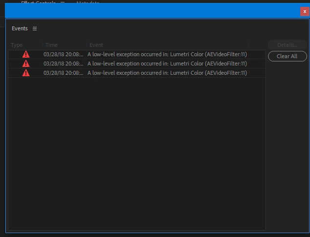

March 28, 2018
I have the same problem when trying to export a clip 1hour long clip. After 12 hours of rendering I get this error when they are left only 7 hours.
I have an I7 8700, windows 10, 16GB RAM. Software mode all the way. The CPU and system wasn't overload.
