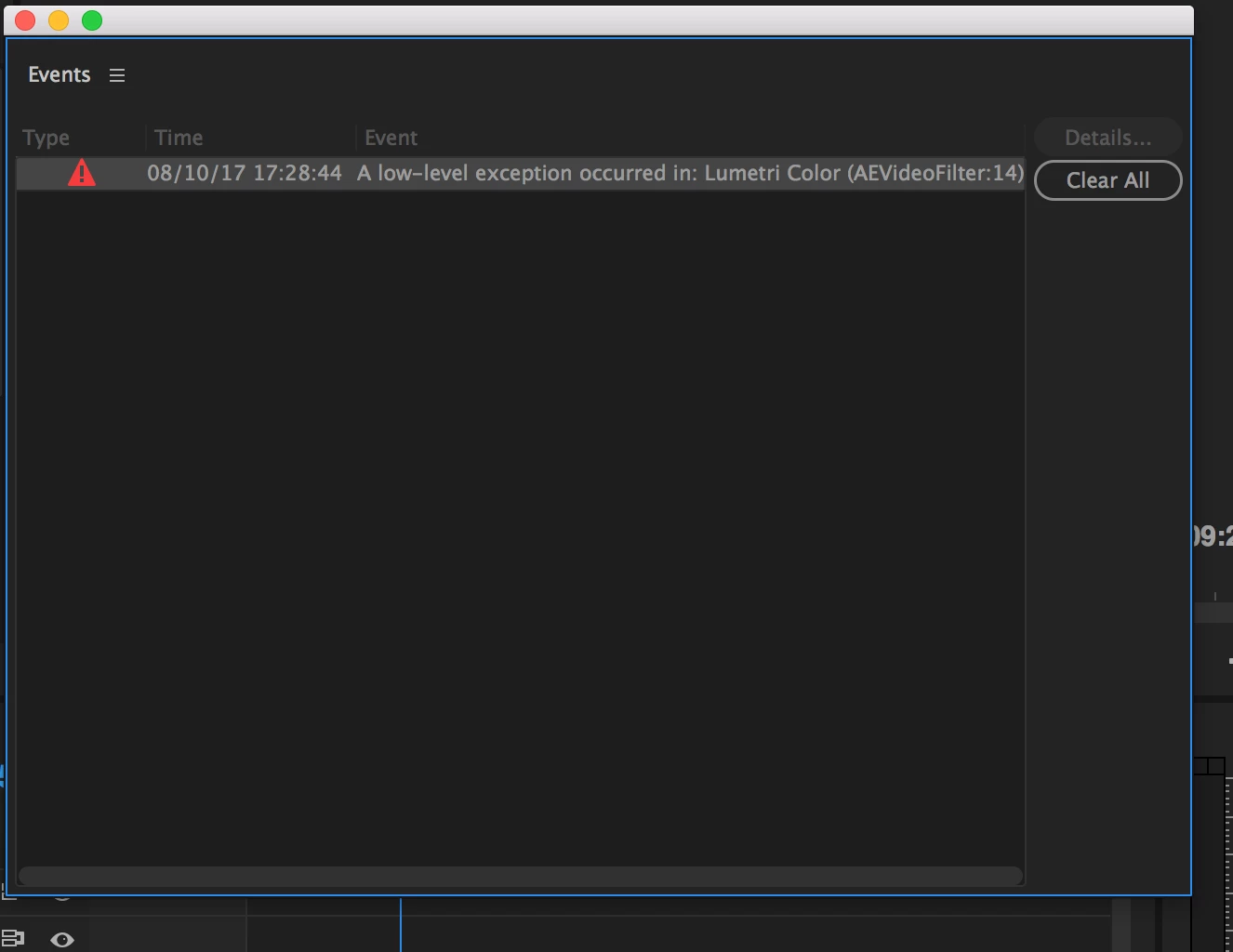

jumpman6323
August 10, 2017
im having a similar problem, I am importing my own LUT's and i keep getting  this:
