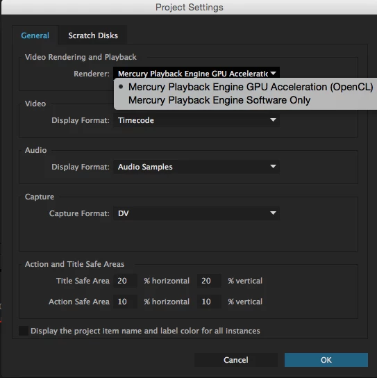

Correct answer Kevin J. Monahan Jr.
If you have a solution that you found, please return to the thread and let us know. We can only assume that you solved your issue. Typically, one will get these kinds of errors when you've exhausted system resources like VRAM, system RAM, or both.
The solution or workaround is to use Software Only mode for the Mercury Playback Engine. You can also purchase additional hardware which may assist the job.
Kevin

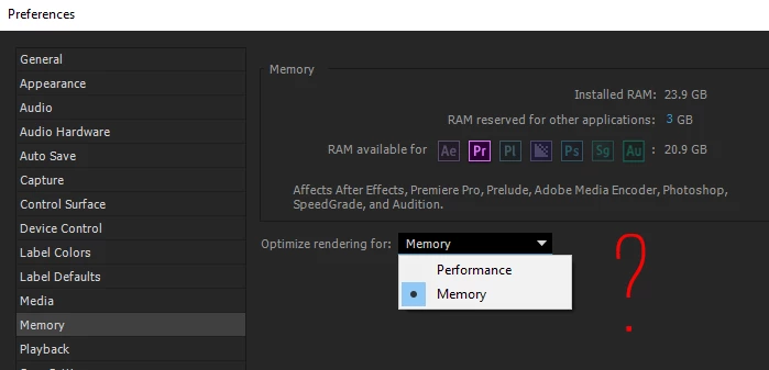

Please explain me what is a difference between performance and memory?
May 18, 2016
By default, Premiere Pro renders video using the maximum number of available processors, up to 16. However, some sequences, such as those containing high-resolution source video or still images, require large amounts of memory for the simultaneous rendering of multiple frames. These sequences can force Premiere Pro to cancel rendering and to give a Low Memory Warning alert. In these cases, you can maximize the available memory by changing the rendering optimization preference from Performance to Memory. Change this preference back to Performance when rendering no longer requires memory optimization.

Workaround, switch renderer to Software Only & export directly from PP CC, do not send to Encoder standalone.

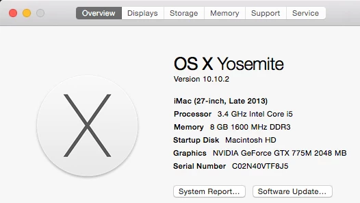

February 22, 2016
I've been experiencing this issue ever since I installed the PPCC 2015.2 (9.2.0 (41) Build) update. I'm running OSX Yosemite 10.10.2
My issue occurs during video editing -- every time I try to apply a LUT in the Lumetri panel, I receive the "low-level exception" message. I've dumped my preferences, cleared my cache, and even uninstalled-reinstalled the program, to no avail. Prior to the 2015.2 update, Lumetri and LUTs worked flawlessly and without issue.
Any word on a potential fix from Adobe??
Dennis Weinmann
Adobe Employee
Adobe Employee
February 22, 2016

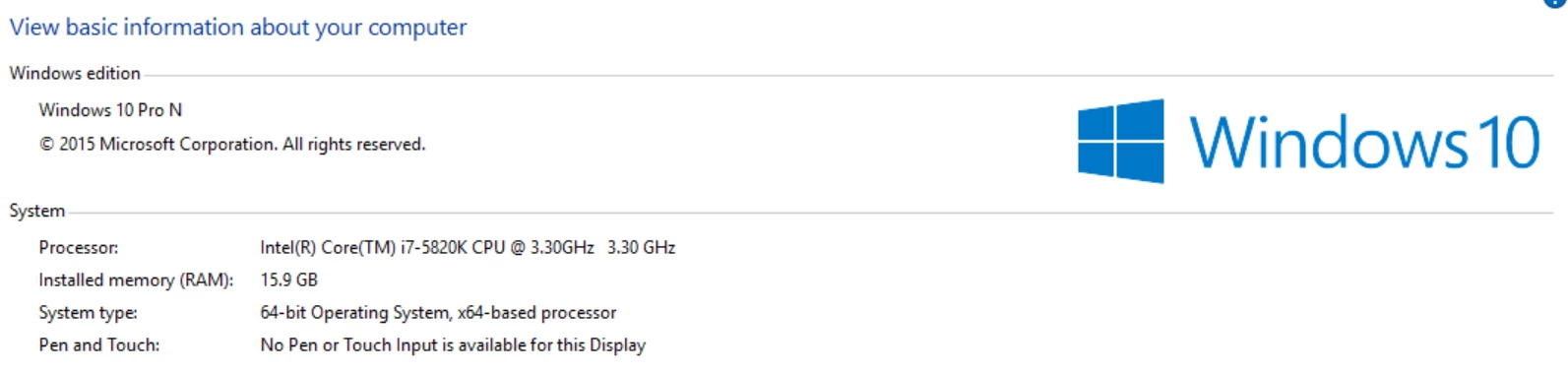

Can you share some detailed system specs + Premiere Project/Sequence settings (OpenCL,Cuda, Resolution, File formats etc)  ?
ckwaller
February 22, 2016
Hi Dennis,
My system specs are as follows:
Project Settings:
Footage came from a Sony HXR-NX5U Camcorder. Footage was shot @ 1080p30. Footage was transcoded via Adobe Media Encoder to DNxHD codec.
Additionally, I revisited a previous (two-month old) project that I completed. This project was completed prior to upgrading to PP2015.2
The project settings for this older project remain the same. However, the footage was captured on a Canon EOS 6D @ 1080p24. Footage was ingested into Premiere Pro natively. LUTs were added via Lumetri panel without issue. Upon opening up that project today in PP2015.2, I received the low-level exception immediately when trying to switch to a different LUT.
LUTs for both projects were applied/attempted to be applied in the "Creative" panel of Lumetri.
