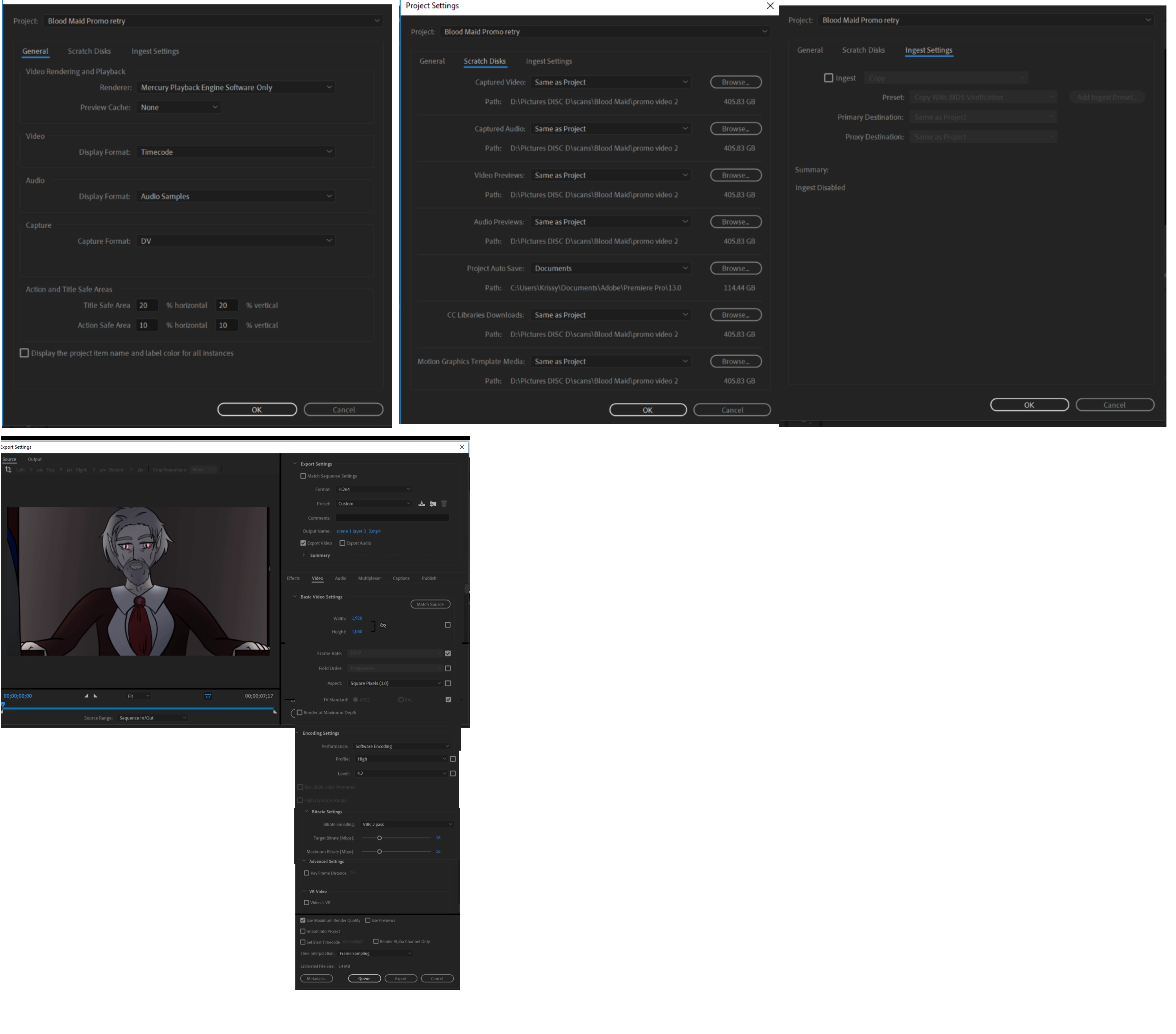

gerikp10383985
Here were the last settings used I did the best I could taking screenshots and piecing them together so hopefully it all makes sense. I am not much of an experienced person in these programs I just use them for simple rendering so I don't really know what I am much doing other than it's not working the way I want it to work. All I have ever rendered previously were recorded videos.
