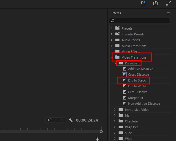

Nguyễn Hữu Phước
April 28, 2023
var qe = app.enableQE();
var qeProject = qe.project;
var qeSequence = qeProject.getActiveSequence();
var qeTrack = qeSequence.getVideoTrackAt(0);
var qeClip = qeTrack.getItemAt(0);
qeClip.addTransition(qeProject.getVideoTransitionByName("Dip to Black"));
I noticed this will add "Dip to Black" between clip (0) and clip (1)
