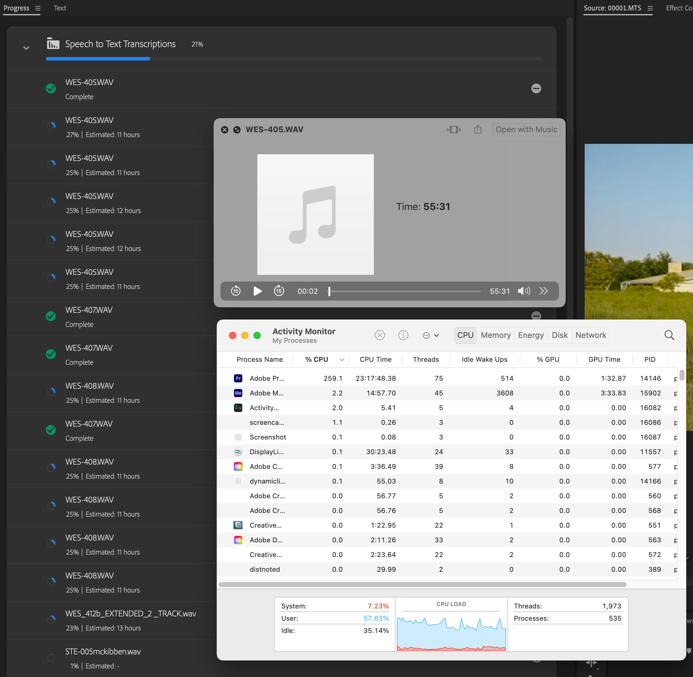

I tried right clicking a few source files in my project window, and then asking for them to be transcribed.  Interestingly, my source files typically have 6 tracks and all six tracks show up in the progress window.  That tells me it's analyzing all six tracks one at a time.  That's a shame.  Track1 of the file is the "mix" and it would be nice if Premiere only looked there to transcribe.
Do you know if there's a way to do that?
After all, having to wait as long as a day for 1 of audio is not very productive.

A big issue I have is that I'm working with off-board .wav audio recordings that go uninterrupted for hours.  Like, 4 hours each.  Unfortunately, the actual part I want trascribed might only be 15 minutes.
Ideally, I'd slap that huge audio source in a sequence, edit out the parts I don't want, and allow Premiere to only look there and ignore the rest.
However, it looks like they way they're implementing the newer features of transcribe, is that it'll analyze the whole source clip...and the best way you can get 'Identify Speakers' to work is to tell Premiere to analyze a source clip.
Is your expereience jibe'ing with my analysis?
