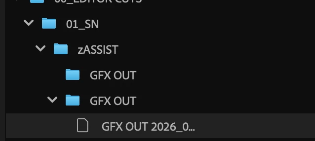

Production Display of Folder Structure & Projects Becomes Corrupted on Only One Computer
My production panel completely removes all my projects from view. Bins seem intact, but there are duplicates of several bins. If I open the production on another computer it is fine. I have restarted and cleared the cache, but the issue persists.
The only thing I can think of to do is to re-install Premiere. But seeing as this isn’t the first time this happened, I’d prefer to figure out what is going on and prevent/fix this.

How it looks in Premiere

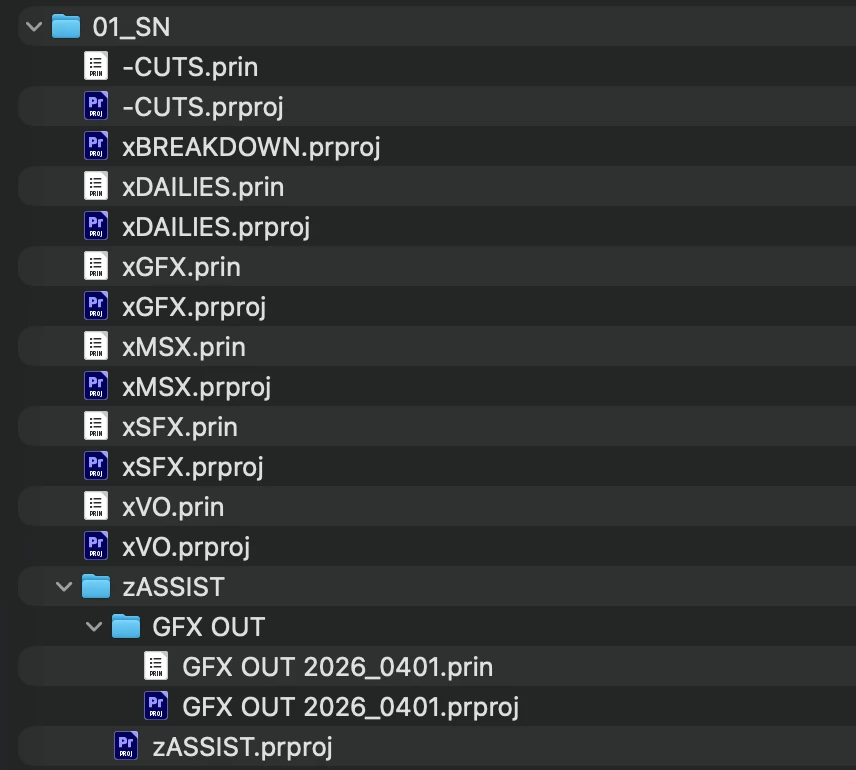

How it looks on finder.

I also just reset all of my LL cache settings and it still doesn’t work. Duplicating the production and opening the duplicate (which requires conversion to a new Production) DOES work, but obviously isn’t really useful since everyone else is still working on the original Production without issue.
