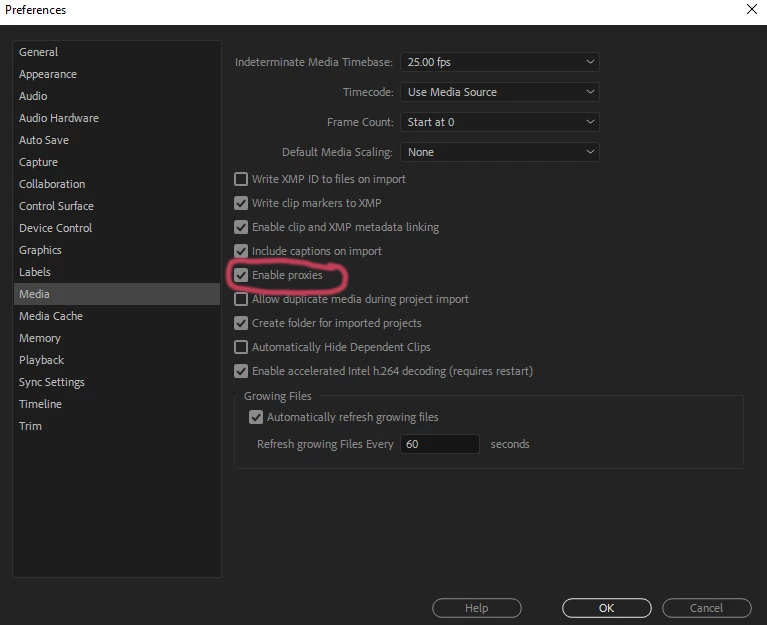

hkudirka
November 12, 2017
Check if "Enable proxies" in Preferences is on, for some reason it was off by default and i also had all these problems with proxies until i found this.
amckc
April 22, 2019
After doing *literally* everything else I could possibly think of to get my proxies playing smooth, THIS turned out to be what was wrong!  I never had any issues with proxies in the past and lately it has been a nightmare - but to find that THIS little tickbox is the reason is ridiculous.  How did it even get unticked to begin with? I certainly didn't turn it off! Thanks for this solution!

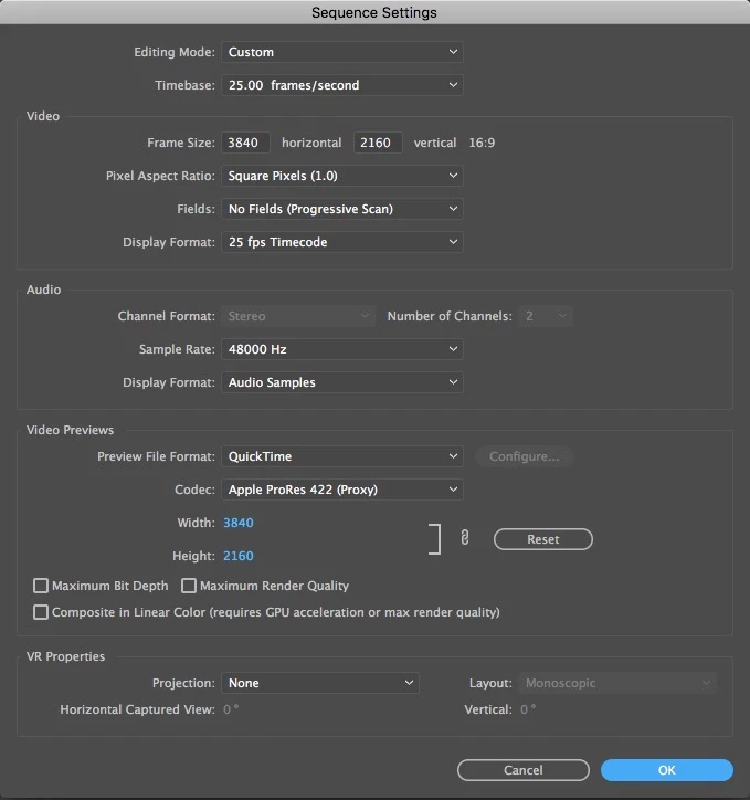

May 31, 2017
I've set up a new test project to try and get this working.
Project and media saved to desktop on a 2013 Macbook Pro with SSD.
I've pulled a 4K Sony XAVC MXF to the timeline and then created a 1024 x 540 ProRes 422 (Proxy) file. Sequence is same as original media,
This project WILL use the proxy, but only plays back smoothly if I set to 1/4 quality. Is this normal?
Proxy file plays back like butter in the preview window. Just not in sequence.
Here are the sequence settings
