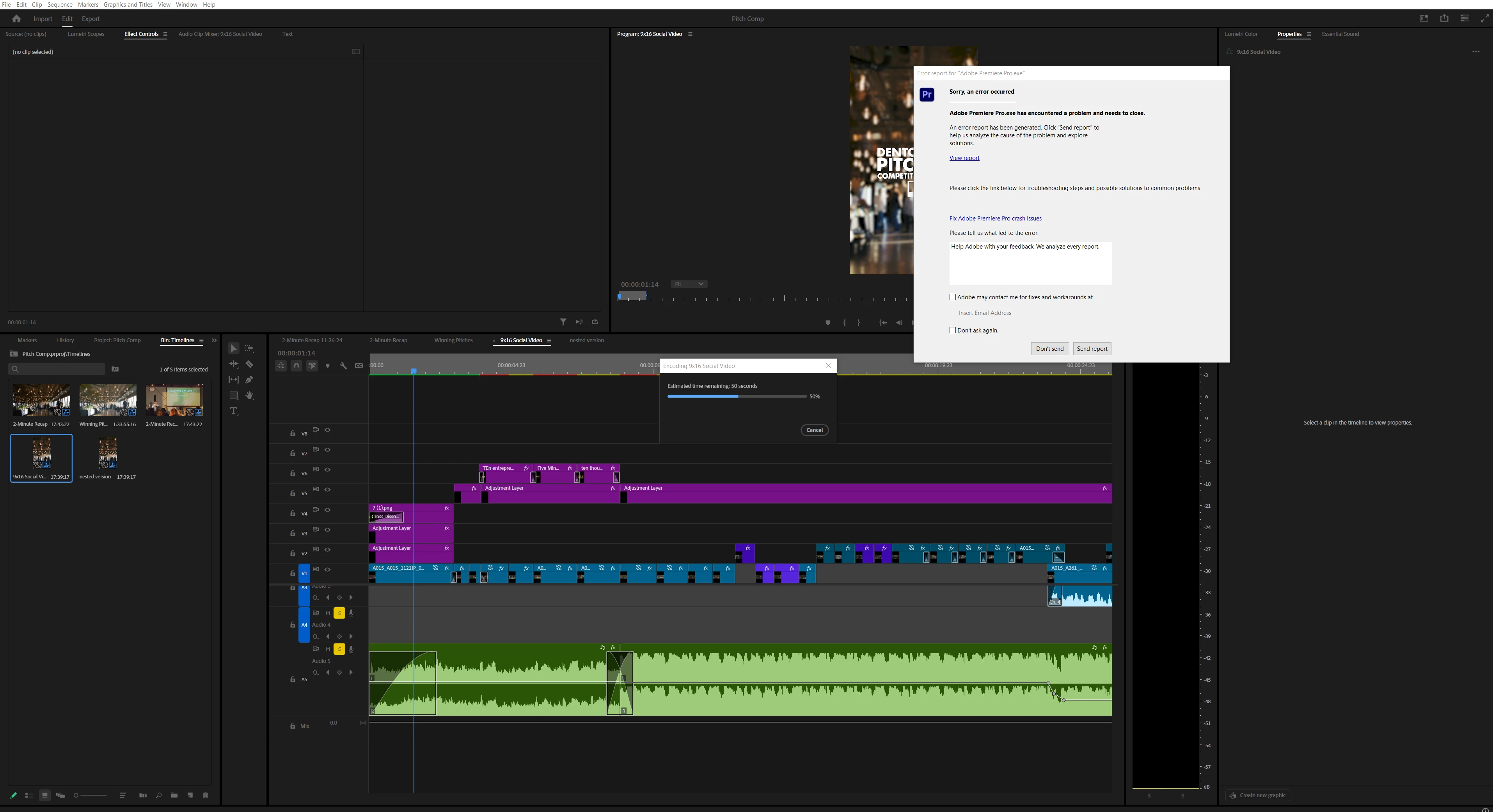

Without fail, Premiere crashes in the middle of a project or during export when working with red raw files.
Sometimes a minute after starting Premiere, sometimes 10, but always happens. Scrubbing, playback, changing setting, anything. Its incredibly frustrating and severely hinders my work.
It also takes me 10 attempts to export, for the same reason. 9/10 it crashes mid export (in ME as well).
I've uninstalled all my plugins, effects, etc and still same issue. I also recently updated my hardware with a clean install, same issue as preupgrade.
Other issue, I cannot use the white balance in the RAW panel with raw clips, crashes premiere.
Previous Hardware:
AMD 5900x
AMD 7900xt
64 GB DDR4 ram
18TB HDD (where project and footage are stored)
1TB NVME (where premiere is installed)
New Hardware
AMD 9950x
64 GB DDR5 Ram
2 TB NVME (where project and footage are stored)
Attached is a sample of my timeline, nothing crazy. Couple text layers, an adjustment layer, clips and, music. Complexity of timeline has no effect on whether I crash or not.
