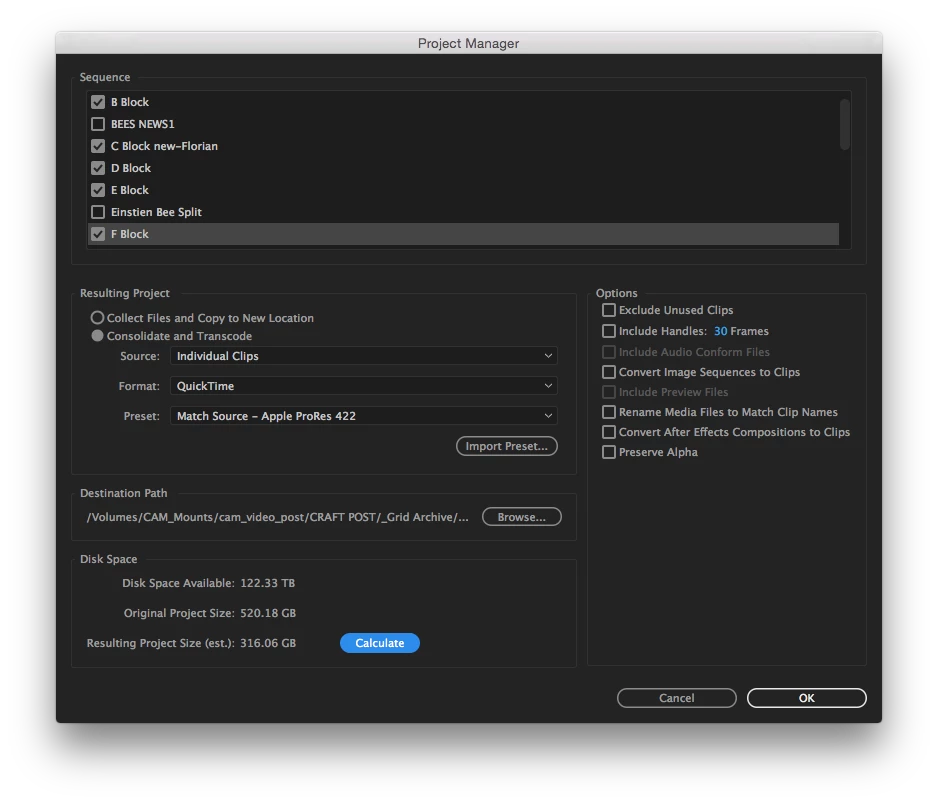

I've been struggling with Premiere's project manager for some time, wherein the Consolidate & Transcode option behaves in unexpected ways.
I just finished cutting 2 seasons of an hour-long broadcast program (42:28 of actual program time per episode) and am facing increasing pressure to manage and archive so that storage space may be freed up.
There are VERY LONG raw interview shoots with multiple cameras each, that I used multicam clips to cut (before project managing, I DO flatten them first and delete all multicam clips from the project). There is also a great deal of supplemental material- Broll, still photos, gfx etc. of various media types & codecs (mp4s, Quicktimes of various codecs, MXFs).
Each episode is a separate project, and on average the original project size tends to be between 500GB and 600GB. So for a TRT of 42:28, I'd expect less than 60GB final consolidated project size (including 30-frame handles), but none have been less than 200GB.
Trying again today, i opted to UN-check the "Exclude unused clips" option, to see what might result and the estimated resulting project size HARDLY CHANGED:
So that's estimating resulting project size to be 316.06 GB,  As opposed to Excluding Unused Clips with 30-frame Handles resulting in 317.65 GB:
(I have the "preserve Alpha" option checked here because there are some graphics with alpha channels that I want it to just copy & not transcode.  Otherwise, all other settings are the same)
I've seen in the resulting projects that none of the interview raws get trimmed at all, and that the multicam clips that contain the entire raw interviews in 4 angles, have all mysteriously REAPPEARED.  The original raws of these interviews are all MXF files... would that be the cause of the problem?
