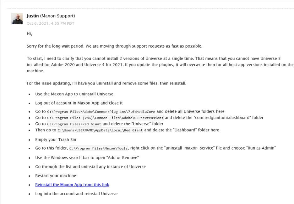

Don't upgrade to 4.0 , went round and round with Maxion Support. Unistalled and Reinstalled ,
cleared out all files
crashed Premiere Pro 15.4 , this is some sort of codec issue involved.
All the other RED GIANT Complete worked fine.
