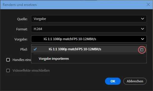

One thing would be very helpful though:
The ability to remove presets from the list. There is a folder path where you can delete it (c:\Users\[UserName]\Documents\Adobe\Premiere Pro\25.0\Profile-[User]\Settings\Consolidate And Transcode Presets\) but it would be much more user friendly to be able to do this directly in Premiere e.g. with a cross in the list.
A little mockup of that idea:
