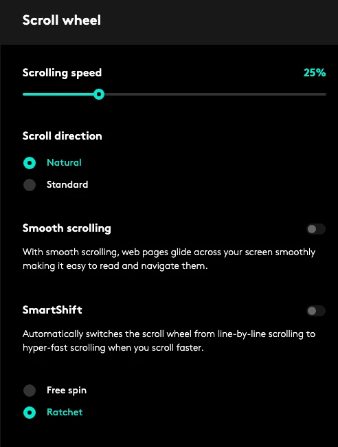

I've been having this issue for a long time as well. I also have the Logitech MX Master 3S for Mac
By changing my scroll wheel options on the Logi Options+ app the following it has helped mitigate, but I can confirm it will still happen if I scroll fast enough
 This has been a HUGE annoyance and would be absolutely amazing if we could get a fix!
