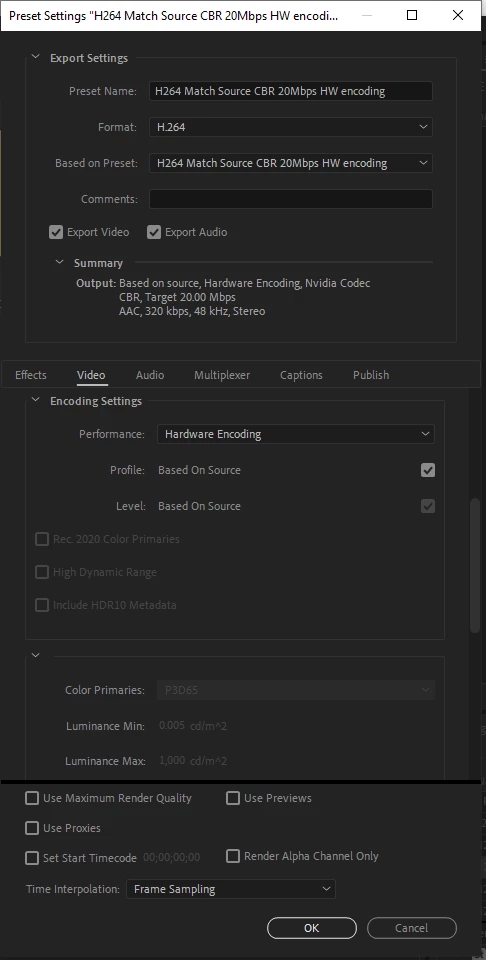

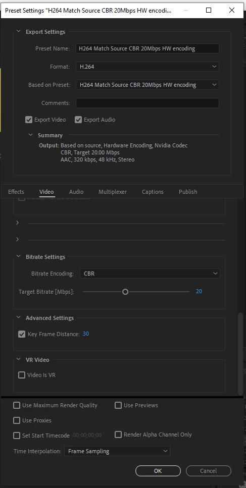

SOLUTION:
Weird.
I used a custom h.264 preset last night to transcode some clips and, as a test, tried to add keywords to those.
It worked.
None of the h.264 presets I tried worked but a custom preset like this did.
I went back and re-exported a project I'd exported yesterday in several presets. This time I used the custom preset and I was able to add keyword metadata with Bridge after export.
I don't know if this will keep working but it's a good first step.
Here are the custom settings I used.

SOLUTION:
Weird.
It worked.

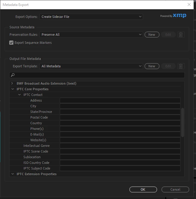

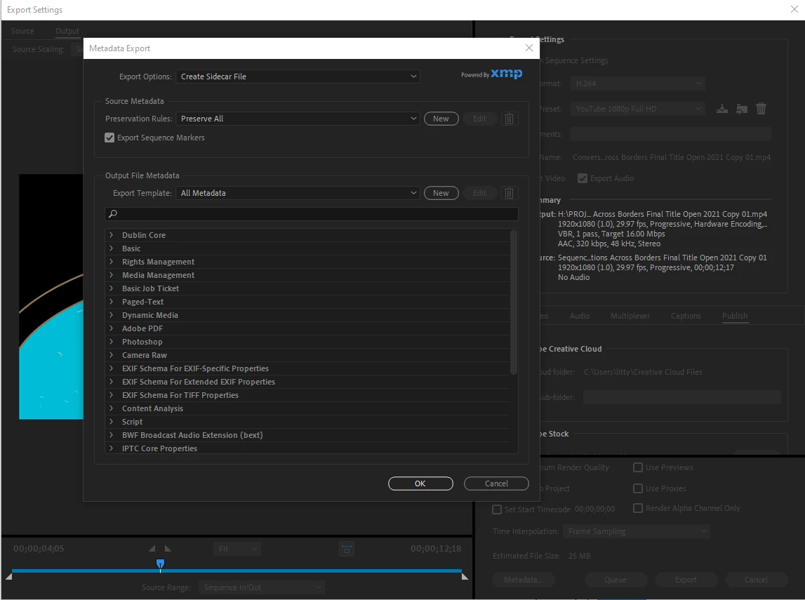

You say you are trying to add metadata in Bridge, after exporting the file?
Have you tried clicking on the 'Metadata...' button at the bottom of the Export Settings dialog when you export from Premiere? This is where you can insert metadata as you export the file.
Michael L at UNCP
September 23, 2021
Entering metadata on export doesn't allow for inserting metadata. I can create a sidecar but embeded metadata is grayed out even though some implimentations of mp4 support it. The only option is XMP sidecar. Also, manually entering keywords for every export without the ability to update and modify metadata after export is tedious, inconvenient and leads to inconsistent tagging.
I have a keyword tree built in Bridge that's pretty extensive that I use for photos and want to use for video products on like-projects across the university where I work. Using the tree keeps keywords consistent for my users searching for images and videos.
Even if I did manually enter keywords for every export and re-export any time I wanted to update them, For some reason Premiere doesn't have the IPTC Core metadata field Keywords used by our online catalog for importing keywords. Bridge has it, Premiere doesn't.
Premiere's metadata implementation feels broken.
Is there a similar compressed delivery format that I could be using instead of MP4 for which Adobe does support embeded metadata? I don't have the hard drive space for ucompressed.
