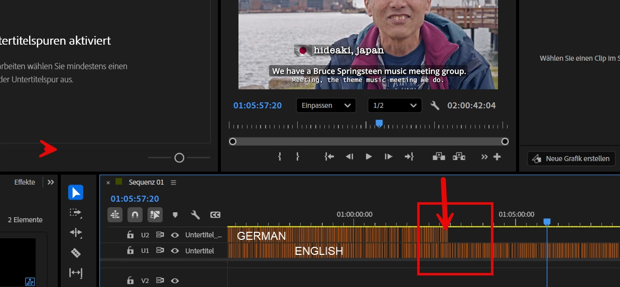

I have a 2 hrs long movie that I'd already fully transkripted automatically in English. The english subtile track is without flaws and the full two hrs.

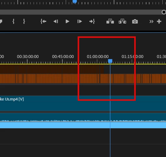

Now I want to have it translated in German. This just works up to 1 hr totally normal. But then there is no further translation.

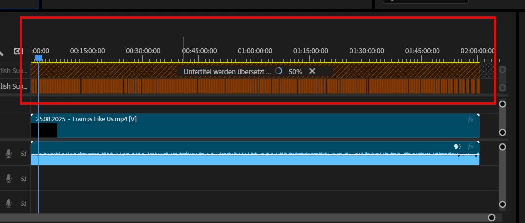

The progress bar of the translation first looks like it's gonne do the job for the hole track, but then it only works up for 1 hour. I can't figure out why this occures or what I have to do to have it fully translated.

I am conducted a few experiments, which are not great because my one hour test worked just fine. My test sequence is from a single clip that is just under one hour long. It happens to have 3 languages, but I am transcribing only the English channel 1. I create captions using the default Subtitle settings. I translate using the default settings to French. The source is "English (Auto-detected)."
The steps I see (via screenrecording) are Preparing captions (10%), Uploading captions (30%), Translating captions (50% for the entire time), Downloading Translation (70%), and Processing Translation (90%). The entire caption track was translated. I placed a clip and sequence marker at an arbitrary location to test translation of part of the sequence - at 32:00:00.
