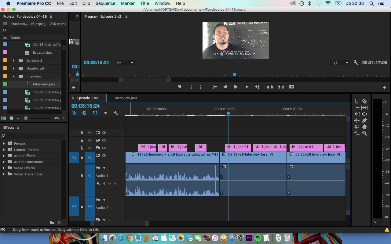

Hi, I have a problem with the sound in some clips.
The sound is only gone at the interview parts (see first image), which is recorded as one file. In the original .MTS file, the sound is there. The sound in these clips worked perfectly fine before, I only noticed after making one small change in an other part of the sequence and watching the exported file afterwards.
As you can see, now there seems to be no sound in these clips at all.

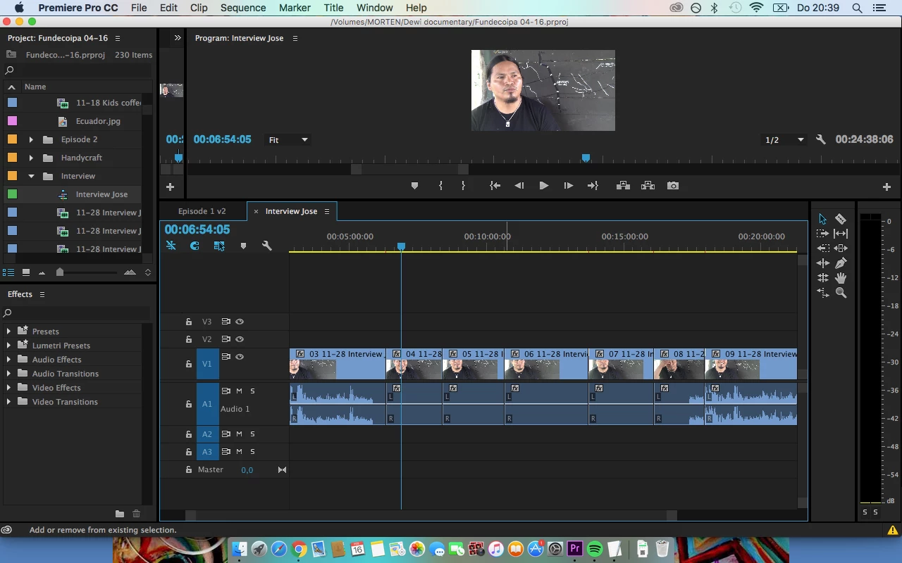

In the second image you can see that the sound only disappeared in part of the interview (it's one imported file devided in several clips).

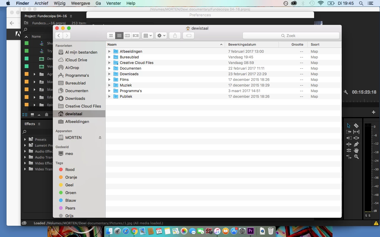

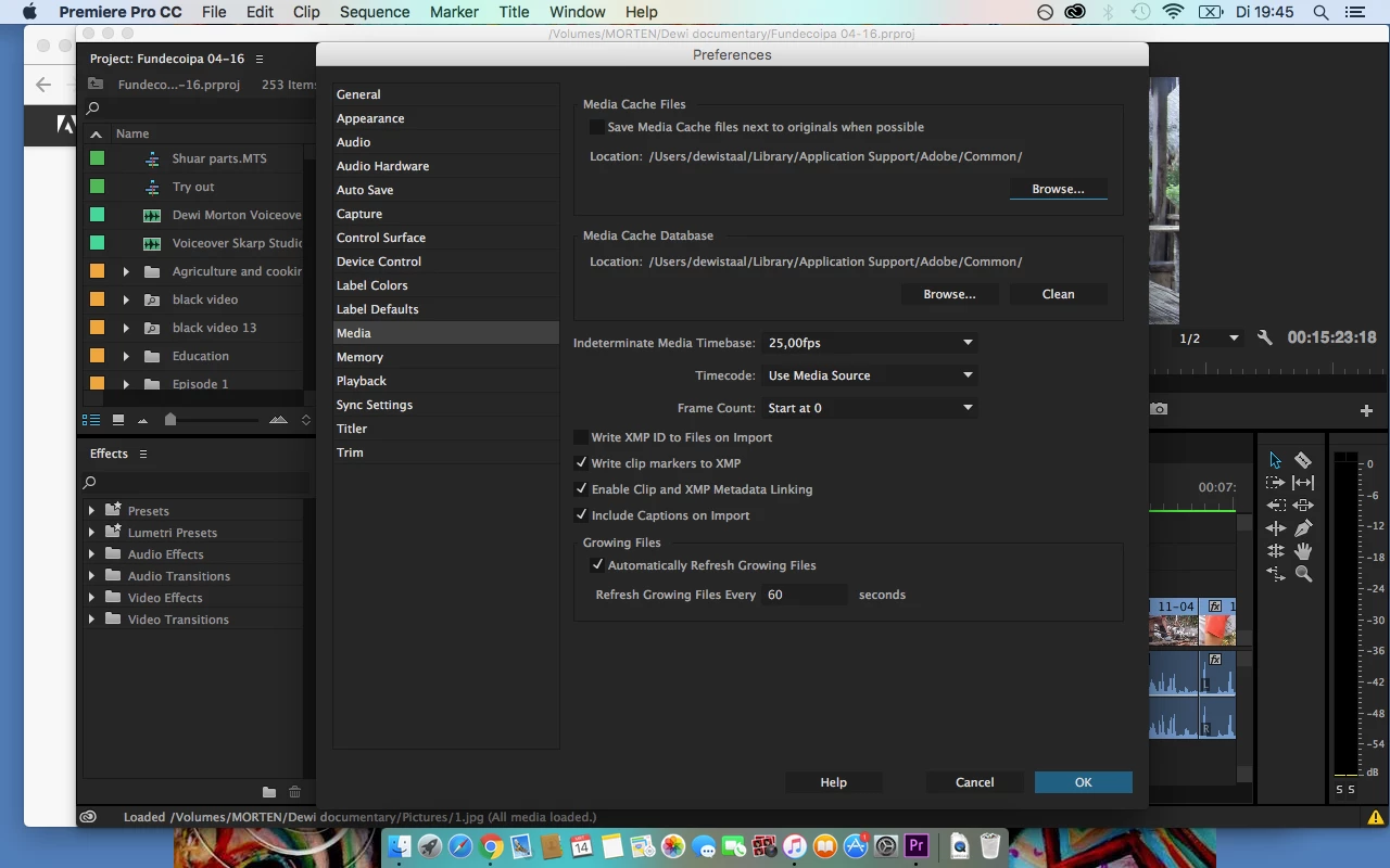

Now I just can't find the media caches. Is that because the box 'Save Media Cache files next to originals when possible' was not checked (see first image)? Would it help if I do that now or will it then only save the files from now on?
I cannot find them either in the Location folder (second image).
Translation of the folders in the image:

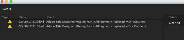

February 18, 2017
What does the yellow exclamation mark tell you?
dewilive작성자
February 18, 2017
Not much that could be of help for the sound I'm afraid...
Thanks for noticing though!
