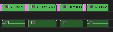

Similar to the previous comment, this also started happening to me after the update mentioned. However I am not using multicam so the issue must not stem from that. But my issue did go away if I deleted all of the sequences where the waveform was completely blank despite audio being present. Shown in my screenshot, all of these sequences have audio in them, it's fairly often that they will have the 'flat' waveform despite this, but the two in the center that are just a blank green rectangle are the ones that seem to be causing the issue since it stops once those are deleted.
The first and second sequences look nearly identical in the way of having the same file types in each, one video layer with a .mov and one audio layer that is a .wav. The files source from the same camera and microphone, and the audio has been edited in audition. So I don't think the files within the sequence are the cause of the issue.
These sequences maintain the blank waveform when being added to the parent sequence again, and the duplicates of them also have the same issue.
