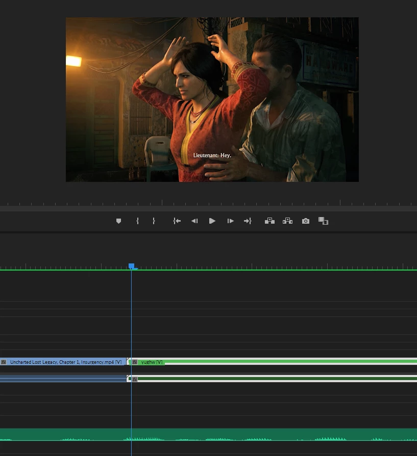

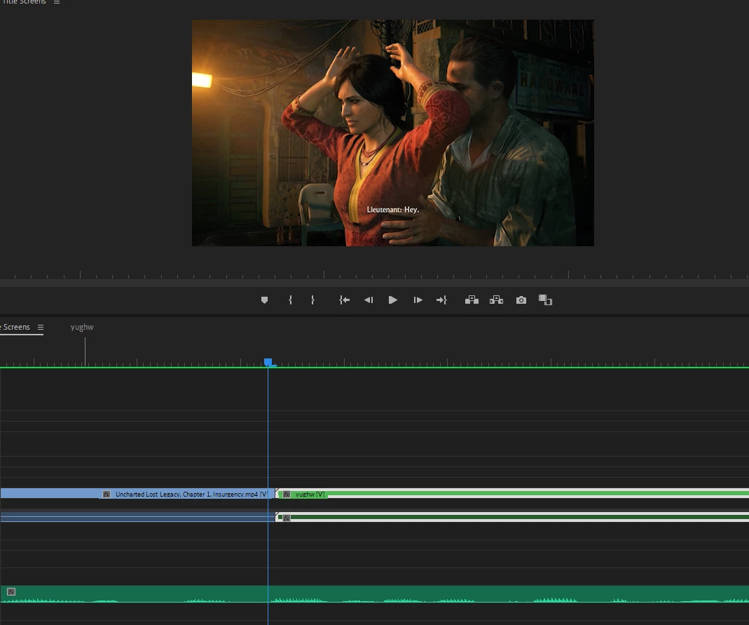

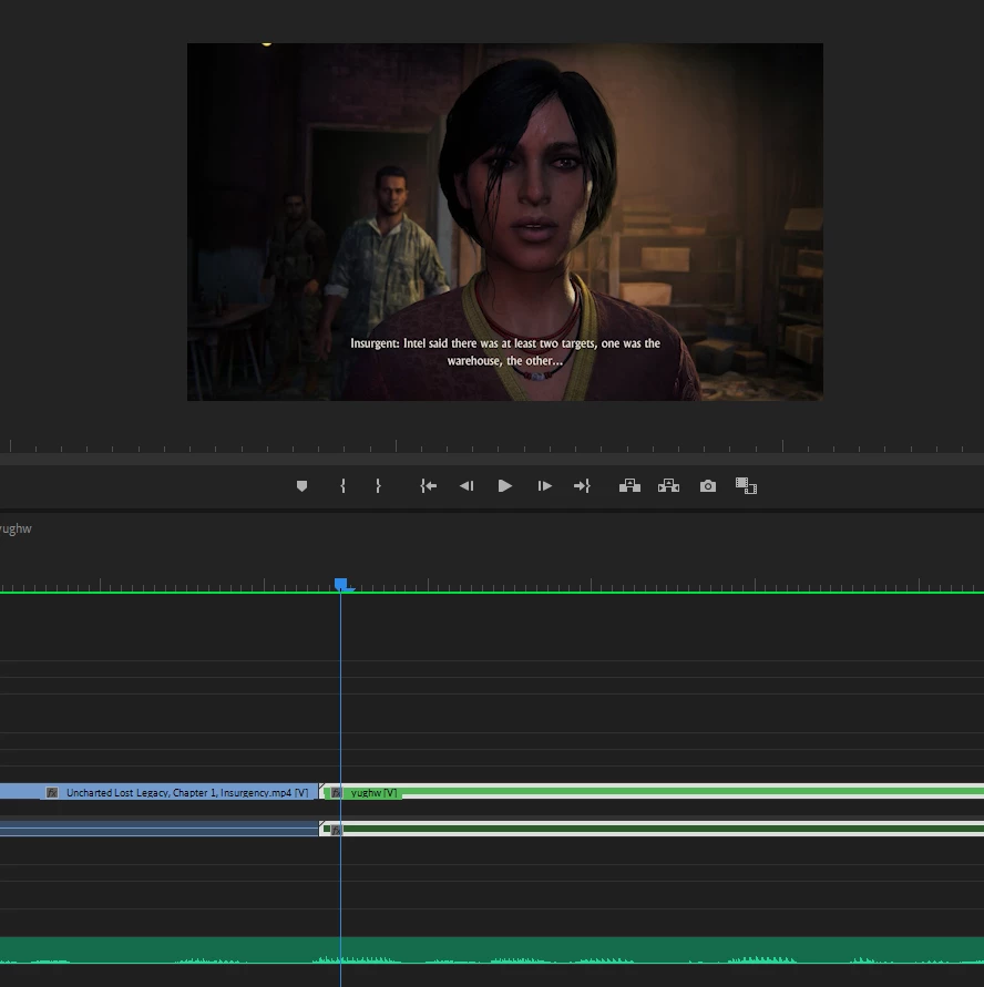

My third issue is separate from the timeline, and it involves one clip having frames from a separate clip that's adjacent to it. So take this for example.
I have two clips, the first clip (in blue) is of a woman getting searched by by a soldier.
And the second (in green) is a different close up shot of that same woman.
However, if I go one frame back on the second (green) clip, you'll notice that it's a shot from the FIRST (blue) clip, when it's clearly suppose to be the second one, since I have the timeline cursor on the second clip.

This is a bit difficult to explain, but essentially the issue is one clip having frames from a separate clip that's adjacent to it. So take this for example.
This is an issue that has PLAGUED my project, and I think it spawns from whenever you adjust the length of clip while it's adjacent to another one, but I'm not exactly sure. Regardless, I like having precise timing of when I switch from one clip to another, so even though it's one frame, it still messes up as lot for me.
The only solution I've found thus far for this issue is to simply nest the clip that has frames from the separate adjacent clips, however nesting things really limits what you can do with clips, and I hate seeing my timeline filled with nests that JUST contain a single clip within them. It's just really annoying to have constantly go back in your timeline to see if a clip you added is ACTUALLY showing the proper thing and not frames of the previous clip.
